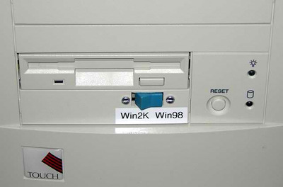

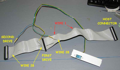

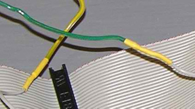

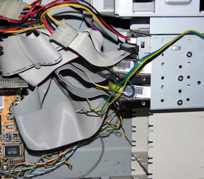

Reply 9 of 65, by Jo22
Guys, there's an even simpler solution with good old IDE/PATA.
Connect 'Cable Select' line to a toggle switch.
That way, you can switch the boot order.
And indirectly select between the Windows XP and Windows 7 HDD as a boot medium.
Edit: Found the article.: http://www.stefanv.com/electronics/ide_dual_boot.html
