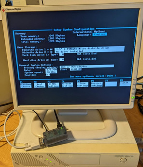

I replaced the battery first, set the date etc, then attempted to get the HDD configured. It's a Quantum ProDrive 40AT.
25.41 KiB
583 views
The BIOS has no custom HDD entry, and no preset that 100% matches the drive. I've tried every preset that matches the advice above. On boot it will only display "HDD controller error." I also picked up a box of other HDDs with this, all small, period correct drives. They all seem fine, spinning up quietly. But no amount of config tweaking gets me past that boot error.
Thoughts?

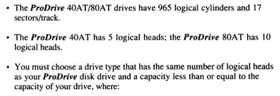

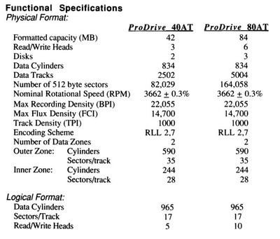

Yeah that would help. It could have a drive overlay which means setting to disk type 1.
Also it could be setup using the physical drive specs of (3 heads, 834 cylinders, unknown sectors <could be 32 or 33>) like the scsi variant of 3 heads, 834 cylinders, 35 sectors/track for some odd reason.
Most early IDE had both physical and logical specs but cannot find the physical specs of 40AT...

Thankfully I have the full manual for the drive: https://www.minuszerodegrees.net/manuals/Quan … on%20Manual.pdf
56.17 KiB
551 views

Progress! The Quantum drive is actually dead. I thought it was spinning, but that was just vibration from the adjacent PSU 😁
So I threw in a Maxtor 7080AT and set it up: https://stason.org/TULARC/pc/hard-drives-hdd/ … -SL-IDE-AT.html
On boot, no more HDD controller error. Now it's "no boot sector" so the system is seeing it, as is fdisk. Looks like this system is good to go.

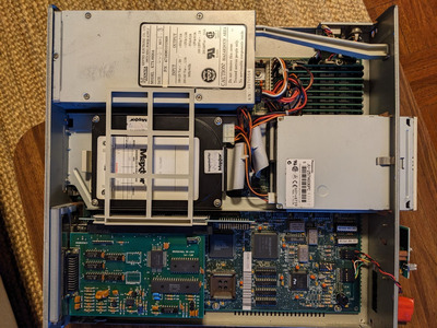

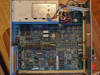

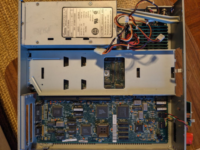

And here is a sequence of reassembly photos for posterity.
509.59 KiB
394 views
409.75 KiB
394 views
386.44 KiB
394 views
418.73 KiB
394 views
