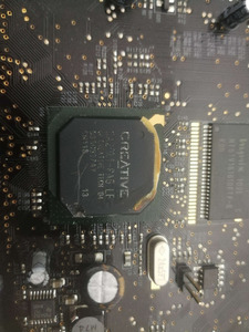

I'm almost done with another period correct build from 2005\6 and yesterday i thought of putting a period correct sound card into the mix, admittedly i took for granted that just choosing any X-Fi card would give me hardware EAX 5.0, that was before i learned about "Xtreme" shenanigans...
Apparently i got kind of lucky and ended up buying a card with an actual emu20k1 chip on it but i want to be sure that the SB0670 card is actually a full fledged X-Fi card able to support EAX 5.0 in games and if i need some driver trickery to actually get the card to behave correctly.

The driver doesn't see the card even though the system sees an HD audio device, os there a specific driver i should look for (XP) ?

Update, the card was sold as 0670 but it ended up being a 460, the card seem to be one of those not provided with the EMU20K1 chip BUT just to be sure i took the heat sink out to have full conformation, it seems to be a fully capable card but now, which driver?

0460 is XtremeMusic and it should work with these drivers: https://danielkawakami.blogspot.com/ or with retail drivers.
I have no other ideas on how to remotely troubleshoot the issue, maybe it would be good to know the complete Hardware ID.
Reply 9 of 9, by iraito
It was a stupid problem, the internal HD audio device was left active in the BIOS, this probably kept the IRQ for the PCI occupied and didn't let the card to be recognized, i always forget that this is a common thing with PCI.
