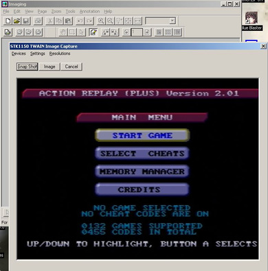

bakemono wrote on 2022-11-15, 09:35:
I use the STK1160 / STK1150 USB dongle in Windows 2000. It does need USB 2.0. Also, I always use my sound card inputs instead of the audio inputs on the USB dongle because the USB audio causes BSODs. (better off not even installing the driver for USB audio)
I now have an EasyCap adapter but can't get it to work under Windows 2000 (with USB 2.0 port). Under Win 8.1 it works and the quality is also pretty good, but under 2K (using VirtualDub) I only get a black picture. Maybe it's because of the weak CPU, a Pentium II 233, but in that case I would have expected frame drops.
Installing it was as you predicted only possible without the sound drivers. One thing is strange: under Win 8.1 it is shown as STK1160, under 2K it's STK1150. Even more strange: under 2K the available inputs shown in Virtual Dub are not only Composite and SVideo but also a Tuner which the stick doesn't have.
Do you have any advise what else I could try to make it work? It's a fresh Win 2K installation with DirectX 9.0c
Reply 6 of 11, by bakemono
You should be able to get it to come up in the Imaging accessory. Go to File/Acquire Image. Then check Settings/Video decoder property to choose NTSC or PAL and then Settings/Crossbar property to choose the input.
If it works there then it should work in VirtualDub. (BTW, my VirtualDub version is 1.10.4 if that matters)

Reply 7 of 11, by HanSolo
bakemono wrote on 2022-12-17, 11:26:
The device is available in the Imaging-app, but I get a white image with a 1 pixel wide black column on the left side. In VirtualDub the black image is replaced by the same white screen after some seconds. I could swear that wasn't the case two days ago. Maybe it changed because I tried different drivers, but now I have again the original one from the CD. The image appears whether I connect a cable or not.
While the white image is shown (in VD and in the Imaging-app) the mouse freezes every second or so for one second.
In device manager the driver has version number 1.0.2.3. Could you check your version number, please?
(I use the same VD version which is the last 'old' one. The new VD2 gives me an error)

Reply 9 of 11, by HanSolo
bakemono wrote on 2022-12-17, 14:15:
My driver also seems to be 1.0.2.3 […]
09/26/2006  07:01 PM           241,628 StkAMini.sys
09/26/2006 07:01 PM 242,728 StkACamd.sys
09/26/2006 07:01 PM 653,988 StkAPin.sys
02/09/2006 05:07 PM 10,479,603 StkAPipe.sys
09/26/2006 07:00 PM 18,754 StkASam.sys
08/01/2006 10:44 PM 4,772 StkScan.sys
Hardware ID is vendor 05E1 device 0408 rev 0005
Are you sure your USB port is working at USB 2 speed and not stuck at 1.1 for some reason?
From a connected USB thumbdrive I read with 10 MByte/sec. (it's not the fastest one but that's way above USB 1.1). But of course it could well be that the USB-adapter is the problem. All files you listed have the exact same size only time is 9 hours later (I assume that's a timezone thing). How can I read out the hardware/vendor ID in W2K? In device manager there's no 'details' tab. (It's my first W2K installation since over 15 years, so I have forgotten quite a lot 😀 )
Maybe I'm missing some important update/component? I didn't install anything except DirectX 9.0c. Without DX the adapter was shown in VD but absolutely no image was received, neither in Overlay nor Preview-mode. My hardware is a Toshiba Satellite Notebook with a pretty basic graphics adapter (C&T 65555 with 2 MB).
I'll try a completely new installation later since this one was only 'for testing'. My video source is a C64 (composite and SVideo) and as I said everything works under Win8.1.
When I have more time I'll do a W2K installation on a desktop with better hardware. Until then, if you have any idea what I could test I'll gladly do that. Thanks so far!
