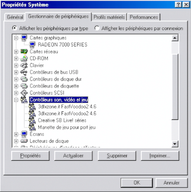

I'm trying to setup a Voodoo 2 12MB SLI with a 3D Blaster and a Skywell Magic 3D but I am really not sure it working properly. I'd like to know how to be sure. For instance, how much memory should be displayed in 3DFX System Info panel.
-The cards are well installed with Fastvoodoo2 4.6 :

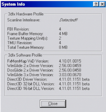

-And the SLI is "Detected" :
download/file.php?mode=view&id=150446
But as you can see the total of memory listed is 22MB. Shouldn't it be 24MB ?

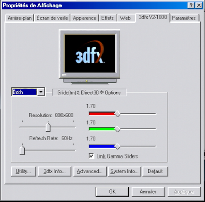

-An other thing is that I can't raise the resolution in the 3DFX panel. Every time I put 1024x768, apply, and come back in the panel, the setting got back to 800x600. But it's kind of new, few days ago it was stuck to 640x480 (I haven't made any change) :
