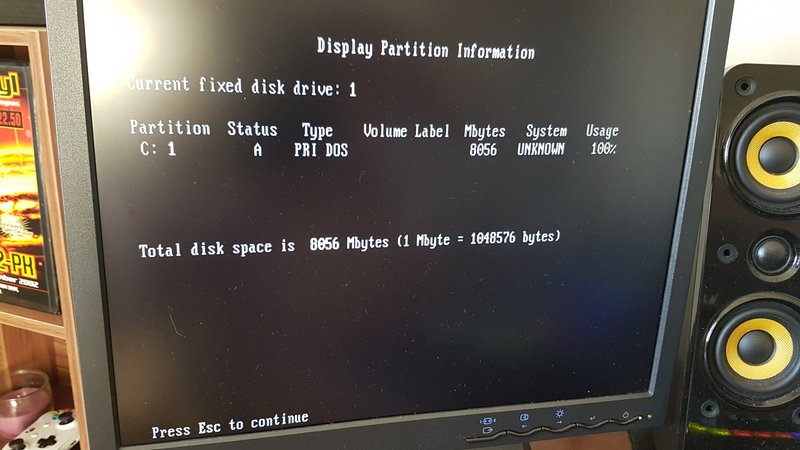

I've got a 32GB Sandisk Extreme Pro in my windows 98 SE build and while using fdisk, even with large drive support enabled it will only ever allow me to create a 8GB partition???
Does anyone know how i can get around this? Oddly enough, this very card was used in another Windows 98 SE build prior to this one and that allowed me to use all 32GB with fdisk.

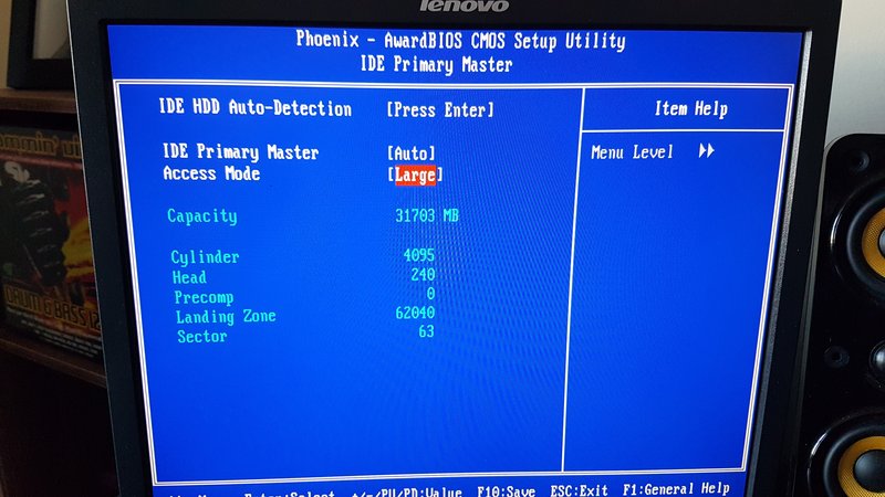

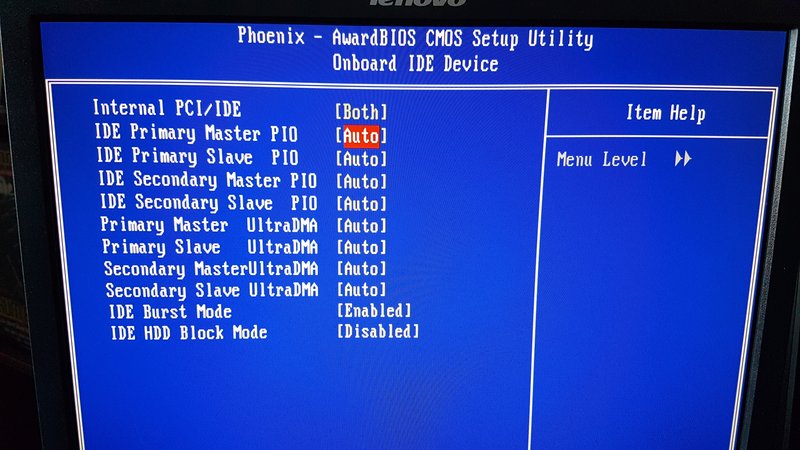

Ok so I've completely wiped my Windows 98 SE install and now I am trying again. Still the same result
I looked in the BIOS there are options for CHS, Large and LBA on the drive i have tried each one and they all produce the same result apart from CHS where fdisk cannot see the drive at all.
So.. I'm a little stuck at this point.. not sure if anything in this option window will help?

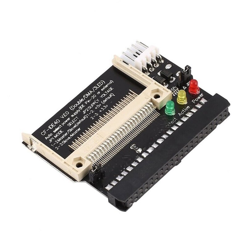

This is the IDE converter i am using
Any ideas anyone? I'm really puzzled by this I've never had a CF card problem like this in any of the other builds I've done including other P4 era builds. This card has been used previously on a Toshiba Tecra M2 laptop and gave me the full 32GB no problem what so ever.

Reply 6 of 15, by drosse1meyer
It looks like your BIOS is detecting the full disk
Where are you running fdisk from? The Win98 boot cd or floppy? That version should allow large disk support / FAT32. Try deleting all the partitions, restart, and fdisk again and see if it prompts to enable large disk support and properly create correct size partition

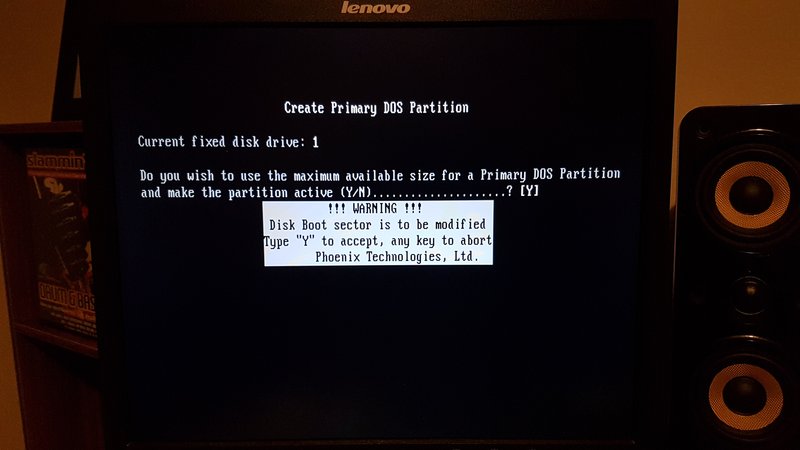

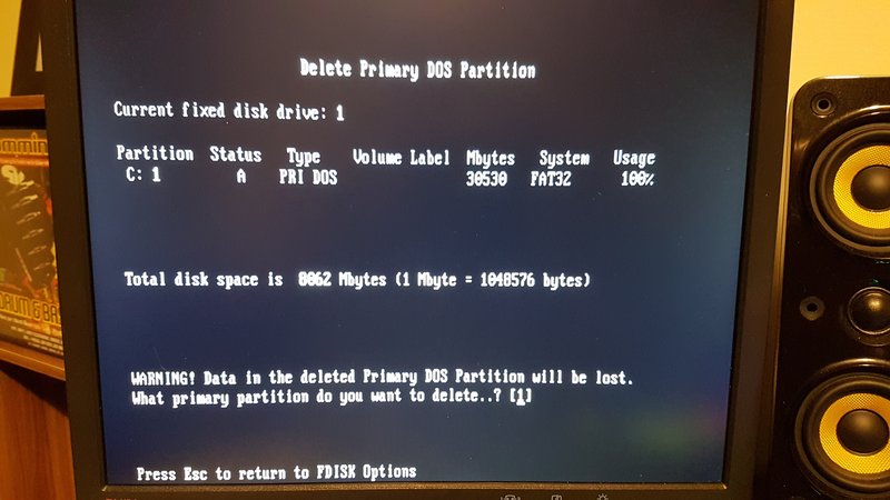

Reply 8 of 15, by dreamscape86
Ok so the plot thickens... this is getting really strange now.

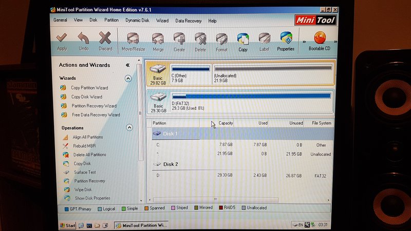

So I booted into Hirens Boot CD as most Linux distros dont like this machine due to the tiny amount of RAM. I got into a partition tool and...

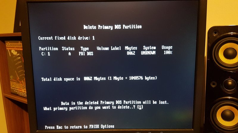

So, fdisk is indeed not using the whole disk. (Second disk is bootable usb so ignore that) I tried to partition it myself (FAT32, set as active) and fdisk then saw the disk properly.
So for the sake of it i tried wiping it and using fdisk to create it.
By doing so i got this prompt??? I'm guessing from the BIOS????
Once complete...
???? so confused ha! I partitioned it again after from the boot CD and tried to just installed Windows 98 without fdisk and Windows 98 setup complained about the disk.
So I'm currently zero'ing the drive so its completely fresh and then I'm going to try and partition it from the boot CD. Either blank so hopefully windows 98 tries to format it or... i don't really know. And that prompt i've never seen before so god knows what thats all about.

Reply 9 of 15, by weedeewee
switch the access mode to LBA and try again with removing the partition, rebooting, and creating it.
FYI. if in fdisk it says :
Total disk space is 8062 Megabytes
don't bother creating the partition, dos or fdisk does not see the full disk.
Do not ask Why !

Reply 11 of 15, by dreamscape86
drosse1meyer wrote on 2022-11-19, 17:27:
OK you manually partitioned and was recognized. Why not just format the partition at that point and then see if Windows will install, and boot?
format /v:labelname /u /s c:
I tried, windows 98 setup didn't like the disk nor tried to format it
I went back into the boot CD partitioned it as blank and rebooted then windows 98 formatted it, installed and now it's full size.
I have no idea why fdisk didn't like it but got there in the end.

Reply 13 of 15, by douglar
Even though your BIOS detect 4095 cylinders, and correctly reports the size of the device, it looks like your system is still hitting the Final ECHS limit when it comes to DOS - geometry up to 8.4 GB (C=1024, H=255, S=63)
You need to find a way to do enable Cylinders > 1024 or enable LBA to go larger than that. Consider changing the access mode to LBA here:
