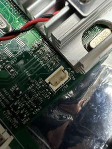

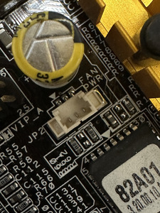

Anyone know what these fan headers are? More importantly where to get the male connectors that go into them. Want to use some Noctua 40mm fans on some old GPUs (like pre GeForce 5). They are mostly 40-50mm 12V fans so power wise will be fine. But the connectors are the trouble!

First image:
Molex picoblade 0533980367
https://www.digikey.com/en/products/detail/mo … 3980367/3263219
You need:
Molex 0510210300
https://www.digikey.com/en/products/detail/mo … 10210300/242843
and the terminal 0500798000
https://www.digikey.com/en/products/detail/mo … 00798000/467822
Second image:
This is a Molex mini-spox and you need : 0050375023
https://www.digikey.com/en/products/detail/mo … 50375023/280418
and terminal : 0008701039
https://www.digikey.com/en/products/detail/mo … 08701039/765268
Reply 5 of 7, by KuroHouou
Wow, thank you so much!! I guess I have some options to think about..
1. Re-solder a new header on board, although probably will be space limited and might not fit a bigger modern standard.
2. Cut the old wire and the noctua wire and use the connector they include (didn't know that's what some of the included parts were for but thanks for that info!!).
3. Buy a new connector to fit the existing header on the PCB and wire it onto the Noctua.
Decisions Decisions now 😀

Reply 6 of 7, by KuroHouou
So I have one more request.. what would this fan header be? Been searching digikey but not exactly the easiest thing to find.. hopefully someone already knows 😉
Might have just found it... does this look right?
https://www.digikey.com/en/products/detail/js … nc/PHR-3/527357
