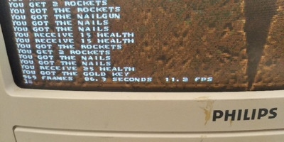

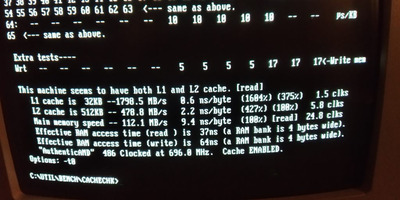

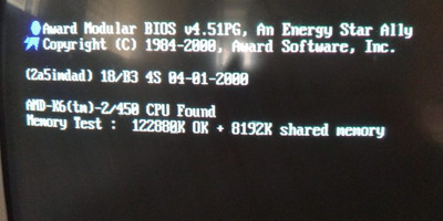

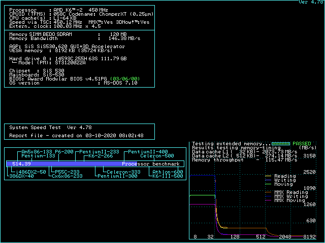

Hi, i have a sis 5595 motherborad, integrated AGP video, ISA+PCI, 128mb PC100 ram, and a K6-2 450mhz. The CPU is running at 100x4.5
i check this
The Ultimate 686 Benchmark Comparison
and if i dont understand bad, in a quake 640x480 timedemo1, a K6-2 450 get like 19fps, but i get 11.2fps
another software i use A LOT, is fusion emulator, to emulate MacOS7 and 8
I have a Celeron 333mhz mendocino, and mac Wolfenstein 3D in Fusion run pretty well, and in K6-2 is very slow

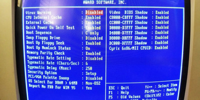

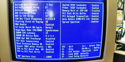

Here is my bios settings
I tried a S3 PCI graphic card, but no difference
Im stuck... or the 686 benchmark is wrong, or my K6 have something bad. Because in 686 benchmarks, i can see a K6-2 450 is more or less than a P2 350-400 in fpu, and similar to P2 in integer... no?¿
