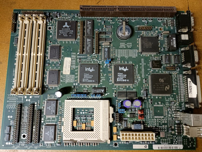

I have just overhauled one of the above systems. It's a lovely little pizza-box sized case with an Intel 430VX board, 2x PCI + 2x ISA (one of each shared), onboard AT24 PCI video, 10mbit PCNet ethernet, PS2 mouse + kB. No MMX support, but that's not a real issue.
I am trying to get large disk support in place as the bios seems to support somewhere around 8GB. My idea was to disable the onboard ethernet and replace with either an RTL8139c or 3C905B fast ethernet PCI card with XT-IDE rom.
However, I cannot get any of the aforementioned NIC cards to work. Neither the 3com not Realtek dos utilities detect a card and I suspect it is down to the onboard AMD PCNet chip not truly being deactivated by the bios 'disable' option.
Anyone familiar with these systems/boards or know of another way to truly disable onboard devices?

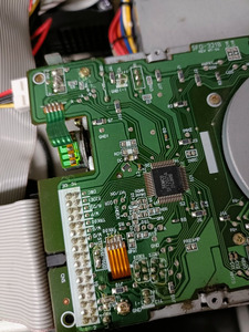

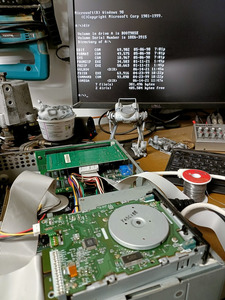

Okay, fixed:
224.57 KiB
442 views
So it seems Tulip did bodge their motherboards to not accept 'standard' PC floppy drives.
I tried all settings I could with the Mitsumi drive, but was limited to just drive select enable IDs (1-4). I knew the Samsung had more options as I recently configured one for use on an Amstrad CPC which needed the ready signal and other mods enabling.
So I started with trial and error; first setting the drive to DS0 (the Samsung is 0-3, rather than 1-4 like the Mitsumi) and it stopped complaining about Drive A at the post... But gave "Drive ready" errors when attempting to access in Dos ... But it did spin the motor... So it was a start.
Next I looked at what other jumpers were available and one stood out - Disk Change. So with that changed to remove the default 0 ohm resistor (defaults to the resistor fitted - I have 3 Samsung drive like this ) I tried again and still had a lack of Post errors, but this time I also got a normal response in Dos accessing A: and the PC booted from floppy for the first time since I put it together.
Tldr; Tulip PC's need floppy drives setting to DS0 (or whatever your floppy drive uses to indicate the FIRST drive signal) AND you must have the Disk Change signal line set as above
I suspect if you do not have a disk change option then you probably can't use the drive in a Tulip. My guess is the Mitsumi drives have a pad for it somewhere, but it's not labelled.

Reply 7 of 10, by weedeewee
Does the floppy cable you are using have a twist in it? It's not visible on the photo.
If it doesn't, that would explain the need to switch to DS0.

I have both twist and non-twist cables. Attached as the end drive on a twist cable a standard 3.5 drive never gets detected as A or B. As a second drive or on the end of a straight cable all drives were *always* detected as B:. Changing DS jumpers on the Mitsumi drive made NO difference whatsoever.
It looks like the Tulip motherboard does the 'twist' onboard and expects drives to be jumpered as DS0 (rather than the typical IBM standard of DS1), as well as requiring the disk change signal to be set as above.
It didn't matter what cable or position on the cable the unmodified drives were connected with, none would ever respond as drive A.

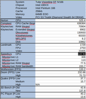

Finally got around to benchmarking this system. It's a good, solid performer, perhaps let down a little by the 72pin SIMM memory implementation (rather than the optional SDRAM interface of some 430VX implementations):
58.84 KiB
365 views
In particular I'm very impressed by the compact flash performance of over 10MB/sec on the primary IDE controller.
I'm fitting a Voodoo 1 (4mb Diamond Monster 3D) to this system alongside the Trio64 (2mb Diamond Stealth 64 DRAM) as it feels like it's the right type of machine to have it. It's also now got an ESS1868F + XR385/DB60XG.
