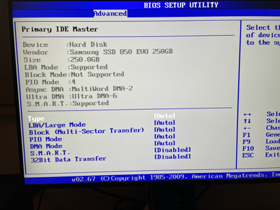

I am trying to install Windows 98 on the motherboard in question, since someone managed to adopt the proper X58 drivers https://www.modlabs.net/articles/installing-w … tel-x58-chipset

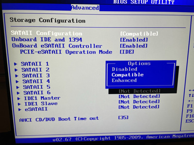

To install Windows 98, I need to set the SATA controller to compatible mode.
502.01 KiB
1087 views

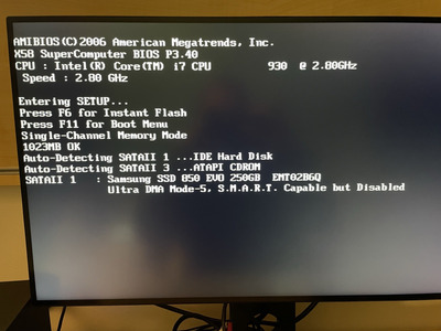

When I do this, however, this point in the boot phase lasts between 3 and 4 minutes (real clock time), during which time the hard disk use light stays on.
If I let the time pass, the computer boots and the Windows 98 boot floppy via mscdex correctly recognizes the SATA CD drive...in short, everything works
438.86 KiB
1087 views
But it is impossible to use the computer with this waiting time at each reboot. Do you have any idea how to proceed? Maybe I need to intervene on these parameters? Or look for an older SATA disk?
455.33 KiB
1087 views
If I disconnect the disc the boot obviously is instantaneous, it seems that the controller set to compatible mode does some kind of "analysis"

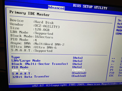

Reply 1 of 15, by Repo Man11
I would definitely try changing the hard disk setting from Auto to manual and see if that solves the issue.
Reply 2 of 15, by matti157
Under type I have:
-CD\DVD
-ARMD
LBA:
-Enable
-Disable
-Auto
Block multi sector:
-Enable
-Disable
-Auto
PIO:
-1 to 4 + auto
DMA:
-A long list of dma modes
SMART
-Enable
-Disable
32bit:
-Enable
-Disable
Reply 3 of 15, by Repo Man11
The screen shot shows how it was detected - I would match all of those setting manually and see if that speeds things up.

Reply 6 of 15, by matti157
Okay by playing with the settings I have better identified the problem.
The motherboard can't access the hard drive if the controller is set to compatible mode.
If I put all the settings manually the boot phase ends right away because the card does not need to access the disk.
But right after that the attempt to boot an operating system occurs and at that point it freezes again for a few minutes until it fails by booting from the second device (the floppy)
At that point the Windows98 boot floppy is loaded, I give the fdisk command and again disk access is attempted, failing again. Fdisk then returns the error "error reading fixed disk"
Ideas?

Reply 10 of 15, by matti157
agent_x007 wrote on 2023-01-09, 13:50:
What style of cable are you using for IDE (40 wire or 80 wire) ?
Also, since this is IDE controller "talking to" SATA SSD, I guess there is an adapter somewhere ?
If so, adapter may not support higher/other modes (that are selected by default by "AUTO" setting).
I do not have any IDE cable. The controller is a SATA (intel ICH10R built into the X58 chipset), connected to a SATA SSD via a SATA cable.
However, set in compatible mode it emulates a PATA/IDE controller and the operating system does not notice that it is working with a SATA controller

Reply 15 of 15, by matti157
I confirm that with the options explained in the posts above it works, soon I will post a thread where I illustrate this strange configuration
