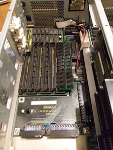

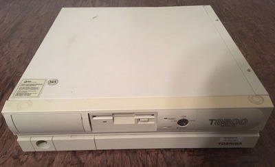

This thread is about Toshiba T-series desktop model T8500, kind of relative to T5200 laptop. I haven't found much information about and writing this for the reason.
According to this https://www.latimes.com/archives/la-xpm-1989- … -300-story.html these might have been manufactured in Irvine. In the nameplate reads: "TOKYO JAPAN".
There seems to be some variants, at least:
- Model 25?, PA5042U = 25MHz, 64kB cache (from the specification PDF)
- Model 20, PA5041E = 20MHz, 32kB cache (this is the one I have)

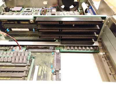

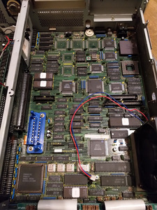

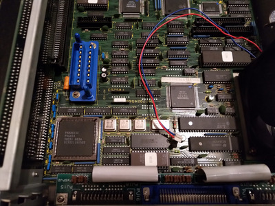

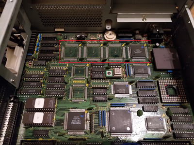

I attached some pictures from inside. There can be found:
- 80386-20
- T9490F-20 32kB cache
- 1MB onboard DRAM

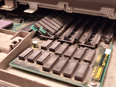

- DRAM expansion board with 1MB onboard and 1+1MB SIMMs (same as in T5200)
- Paradise PVGA1A
- SCSI+IDE+floppy(same cable pinout as in T5200)
- 3x16-bit ISA + 1x8-bit ISA which needs special back plate to be used(I don't have that).
There's 3 empty cache footprints (red box). I'm thinking about ordering T9490F-25 chips to expand cache to 128kB (4x T9490), but I'm not sure is that just "plug-and-play". I assume -20 and -25 stands for corresponding CPU FSB.
Does anyone have 25MHz variant? Would be interesting to see assembled cache chips.

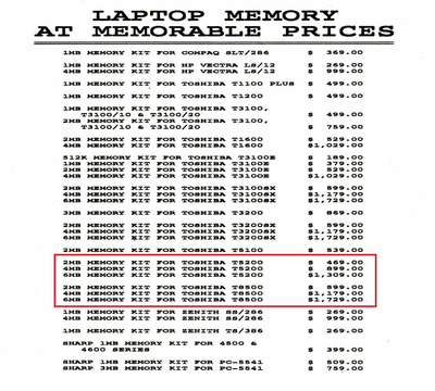

Price information shows that T8500 SIMM memory is more expensive than for T5200. I think it's because of 25MHz FSB vs 20MHz in T5200. Same 40-pin SIMM should fit both.

InfoWorld Laptop memory prices

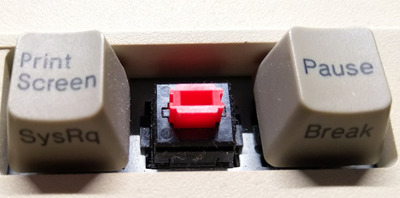

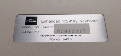

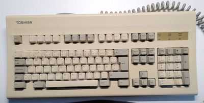

I totally forgot to write about the keyboard.
This seems to be quite rare case with red and clicky Alps. It's rebranded Alps Bigfoot with red switches. Personally I like the feel more than IBM Ms. Anyway, that has been documented now here...
Thread @Deskthority https://deskthority.net/viewtopic.php?t=20339

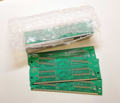

One step further. Memory IC order to be postponed until CNY ends.

Reply 8 of 29, by fool
Thanks for asking. Yes, there's parity bits (4) included. Toshiba surely didn't make this RAM configuration easy. Maybe one of the reasons why it never took off.

Memory chips are so expensive that I will only produce minimum amount to verify the design. If these are functional we can discuss more via email. But there is many variables to deal before that step.

Reply 12 of 29, by fool
Pinout, size and memory organization are sure different. There aren't much compatible ones in this world. But don't worry. I just checked today and my supplier has some stock left.
I have another design with more common cheaper implementation but thats only 1MB/stick. I can order PCBs if there is some kind of need...
Jumper on this 4MB stick allows to cut down the size to 1MB if mandatory due to weird memory layout in Toshiba. Haven't checked it really, it was easy to implement just in case.

Is those 40 pin simms made up of 16 bits plus parity plus address lines? If it was actually 32bits plus parity per simm, that would take 36 bits total and 4 pins for power. No room for addressing?! Lol.
Because, these 40pin simm contains 8 4 bit wide 256k chips which is 32bit wide which is impossible, since I'm confused unless these chips is tied together as 16 bits with total of 512K split into 16 bit plus 2 bits of parity wide of 2 banks of 256K plus address select to select either 256K or second bank 256K.
Still, I'm not aware of any memory chips IC package with odd numbered data lines to include parity. Usually 1bit, 4bits, 8bits or 16bits wide IC packages.
There are 4mb package with 16 bit wide found on 2 (4MB) or 4 chip (8MB) 72 pin simms which allows you to reuse one 16 bits IC plus two 1 bit parity ICs and have room to spare to create 4MB 40 pin simms, still needs parity.
Anyway, the soldered 8 chips on the daughter board is for other uses not for main memory, is I'm correct?
Cheers,
Great Northern aka Canada.
Reply 18 of 29, by fool
Yes, these chips are 16bit + 2bit parity (2CAS) each. In SIMM module there is 2 RAS lines to select chip. So there are two double 8+1-bit column chips in 2 rows.
In the 8+4 chip module there is... ok here is hopefully illustrative picture. So that one 42-pin chip is the same thing as all green RAS1 chips combined together, except with one more address input.
That 8 RAM chips on that card are main memory. There are 8 chips more in the main board. I assume those are 1+1MB total.
