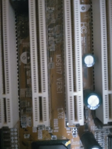

I got this motherboard working (missing inductor taken from dead mobo) and I am confused what update file should I get? I only know I have Award BIOS from 1997 and I'm waiting for Intel Pentium 2 266MHz SL2HE as my other SLOT1 processors show weird numbers and MMX processor.

Assuming you simply want the latest available BIOS for your board installed.
Looks like that board shipped with both 1Mbit and 2Mbit BIOS EEPROMs. You'll have to find out which one you have. Easiest and surest way would be to just look up the EEPROM part number printed on the top of the chip, but that would probably involve removing a sticker covering it, which you might not want to do. You could also dump the currently installed BIOS - use Awdflash bundled with any of those BIOS updates - and check its size. If the dump is 262144 bytes you got the 2Mbit chip and want the first download in your screenshot (3.2), if it's 131072 bytes you got the 1Mbit one and want the second one (2.5).
If you got the 1Mbit version, you might also want look into getting a suitable 2Mbit EEPROM and hotflash the 2Mbit BIOS to it. Might be a little bit scary if you haven't done it before, but it's easy enough. Just boot the computer to DOS, carefully remove the 1Mbit chip and install the 2Mbit one without shorting anything and then simply flash the 2Mbit BIOS with Awdflash as any other BIOS update. You can prepare by removing the chip before, and reseat it loosely, just enough for all pins to get connection in the socket. Makes the hot removal part a little bit easier.
If installing the latest official BIOS doesn't sort the weird numbers etc, the rom.by BIOS Patcher probably would be helpful. I've used it a couple of times to add support for newer CPUs in 440LX boards with Award BIOS.

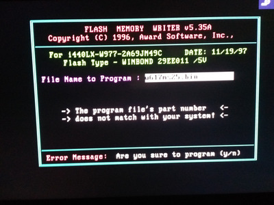

Guys help, I took BIOS file from mobo but I cannot flash new one because doesn't match something. BIOS in attachement, what to flash?

Reply 15 of 25, by haker120
This to be exact.
Reply 16 of 25, by kaputnik
haker120 wrote on 2023-01-13, 15:48:
This to be exact.
Try the bios you can download here. Compared the ID from the POST string (440LX-W977-2A69JM49C-00) to the one from your dump, it's the same. That image should work with your board.
If it doesn't , we'll try a stopover on some version between the one installed on your board (1.4) and the latest (2.5). Have had to do that on one or two occasions 😀
