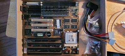

As per the picture my motherboard's jumper's are as follow:

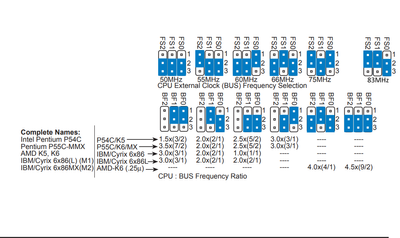

- Voltage Configuration (VID0-VID4) is set to 2.9v (same number as on the cpu. i think that's how this works?).
- Single/Dual Voltage Configuration (JP10) is set to Single Voltage CPU.
(the jumper was already on the board, i left it there since my cpu only as the 2.9v present on it; and i've seen pictures of k6 cpu's which have for exemple 3.3v i\o written next to that; which i assume those are dual voltage cpu's.)
- CPU External Clock (BUS) Frequency Selection (FS0/FS1/FS2) is set to 66mhz. (on cpu-world my cpu is stated to have 66mhz bus so i'm sure this is set right)
- CPU : BUS Frequency Ratio (BF0/BF1/BF2) i think i set it properly to a 3x clock multiplier but i really am not sure on this one.
Main question is are all of these properly set?
Other small questions:
- What is the 6 pin header under the AT keyboard port used for?
- Are the JP4, JP5 & JP6 headers correctly set?
- What is the JP1/JP2 header used for? (has ten pins and is empty)
- There's another jumper with R57 under it and SMI next to it. It is empty but again what is it used for?
I included the diagrams i used for the voltage and bus configurations as well as 2 pictures of my motherboard with the jumpers identified.

- Voltage Configuration (VID0-VID4) is correctly set to 2.9V Vcore.
- Single/Dual Voltage Configuration (JP10) needs to be set to Dual Voltage CPU, so remove the jumper on JP10. The AMD K6 is a dual voltage CPU and your K6 needs 2.9V Vcore and 3.3V Vio. I don’t know why your K6 only indicates the Vcore value, but I think it’s just an omission.
- CPU External Clock (BUS) Frequency Selection (FS0/FS1/FS2) is correctly set to 66mhz.

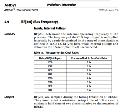

- CPU : BUS Frequency Ratio (BF0/BF1/BF2) is presently set to a 3.5x multiplier, so with this setting you would overclock the K6 to 233MHz. For a 3x multiplier, use the Pentium setting.
This is the complete BF[0-2] information for AMD K6:
The attachment K6 multiplier BF setting.png is no longer available
Without a motherboard manual, my best guess for the other jumpers/headers is:
- 6 pin header under AT keyboard connector: header for PS/2 keyboard or mouse bracket?
- JP4 jumper: BIOS flashchip 5V/12V programming voltage selector or flash disable/enable selector?
- JP5 jumper: unknown.
- JP6 jumper: 3.3V/5V DIMM voltage selector?
- (JP1)JP2 header looks like an USB header for an USB bracket.
- SMI jumper: stands for System Management Interrupt that can put the CPU is a very low power state. Used for enhanced Power Management if the CPU supports it. I would leave this jumper open.

- To set my cpu bus frequency ratio to 3x multiplier is this the proper setting, as in the picture i attached? Sorry i just had trouble reading that part of the diagram the first time for some reason.

- For the JP6 jumper; assuming it is for selecting DIMM voltage, would it's use be relevant when using either EDO or SDRAM? Would the jumper need to be absent or present when using either type of ram?
From your motherboard picture, I see a 3-pin header under JP6. So the selection will be jumper on pins 1-2 or 2-3.
Assuming JP6 doesn't do anything with the SIMMs, and if the SIMMs you have on the board are original, just leave JP6 as it is now.
Yes, with BF0 = 1-2 and BF1 = 2-3 (and BF2 = 1-2 or open) you get x3.
