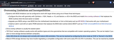

[EDIT] random thought, while they shipped with 120GB drives I imagine it isn't a real bios limitation so much as a bios quirk when interacting with dos + the cf adapter, which happens very often in regard to storage if many threads on here and my own anecdotal experience aren't any indication. Tried to look for a fan mod beyond the 2003 update that's already installed, found none.
I crossed out my questions, because fundamentally dos+my current bios = a hard read of the disk at exactly 8GB, so any of my proposed ideas won't work.
Reply 8 of 12, by rishooty
Fixed! Answer Clue was in the wiki, just not in a very obvious section. I changed LBA to CHS and it [edit: somewhat] works now.

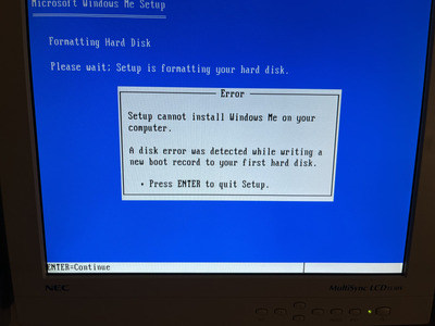

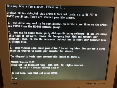

[EDIT]
Nevermind the above. With win98 fdisk or super fdisk it gets as far as formatting and partitioning, but now win98 doesn't recognize it.
[EDIT2] It looks like it never actually saves the format. WinME proved this when it formatted and immediately tried to install after.
    1.75 MiB
    899 views
    mefail
    1.47 MiB
    899 views
    98fail

    WikiSection
