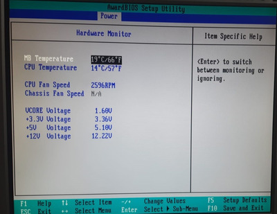

Reply 4 of 15, by deksar
I installed WinXP -temporarily-, CPU-Z, GPU-Z and Nvidia Control Panel don't give any temperature info for the GPU, at all.
Tried SIV utility as well;
By the way, VCore Voltage seems 1.60V for my CPU. Is this normal for a proc: Pentium 1.8A - 1.8 Ghz model SL63X 512 KB Cache? (Because SIV utility reports it in "red")
And CPU fan under SIV is reported as: 0 RPM, but BIOS supplies that info correctly; 2596 RPM.

Clearly Fan 2 is the CPU fan and I expect SIV reported Fan 1. Basically I need to adjust SIV to report Fan 2 as the CPU Fan. Please do Menu->File->Save Local and post to two generated files so I can adjust this and test the change. Please also post a screen shot of what the BIOS monitoring screen reports.

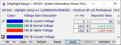

The CPU Core voltage is what the W83697HF reports and I suspect this is correct, but would need to check the save file to figure out why SIV defaulted to showing it in red. What does Menu->Tools->Configure->Highlight Setup report for the VIN voltages? If you change these and press [Apply] or [Save] the colour should change.

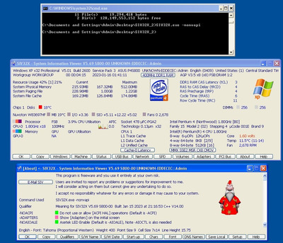

Given the GPU-0 P12 SIV must be using NVAPI rather than NVCPL. If you do SIV32X -NONVAPI then SIV should use NVCPL to try and get the temperature, does it succeed? If so I will adjust SIV in light of this.

Hi again red-ray,
I've attached the files/screenshots you requested. Hope they'll be useful for improving SIV.
I've also attached the screenshot when using -NONVAPI. Seems nothing changed? (It reports my card as 'GeForce FX 5963' instead of FX 5700)

Reply 7 of 15, by red-ray
deksar wrote on 2023-01-15, 20:43:
And regarding the red blob to the right of disks, I attached "smart.jpg" file showing the screenshot of that part - seems no errors?
It still says P12 so for some reason it's still using NVAPI, check Menu->Machine->GPU Info and it will still report NVIDIA NVAPI Library, Version 175.19 C:\WINDOWS\system32\nvapi.dll V6.14.11.7519.

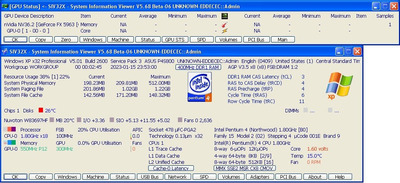

Sorry for the delay, it took me a while to deduce how it came up with 5963, I now know why and hope I have fixed it in the attached SIV32X 5.69 S800-00 test SIV, have I?
It should also fix the CPU Fan reporting, but I can't guess as to why SIV32X -NONVAPI still used NVAPI. I tried it on this system and NVAPI was not used. What does [About] report as the Command Used?
file.php?id=155110
The root cause of the FX 5963 is SIV needing to change such as 7001 USB OHCI Host Controller to 963 USB OHCI Host Controller as SiS use the same PCI Device ID for different chipsets, press [PCI Bus] then [PCI Info] to see the Stock Device Description to Resolved Device Description mappings.

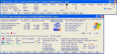

Reply 10 of 15, by deksar
Thanks for the updated version, I've attached the screenshots once again here.
It seems my gpu is correctly identified and CPU fan speed is correctly reported now! However, still no GPU temperature there.
And it doesn't really matter much but CPU core voltage is still in red.

Reply 12 of 15, by red-ray
deksar wrote on 2023-01-15, 22:45:
Thank you for checking out the changes. To change the CPU Core colour update the voltages to say 1610 + 1620 then press [Save].
file.php?id=155116
Now -NONVAPI is working no GPU information at all was displayed 🙁. This was triggered by the Chipset ID being 436 rather than 036 and cid rather than ( 0x01FF & cid ) being used in a check.
I have adjusted SIV32X 5.69 Beta-00, when -NONVAPI is specified what does Menu->Machine->GPU Info report?

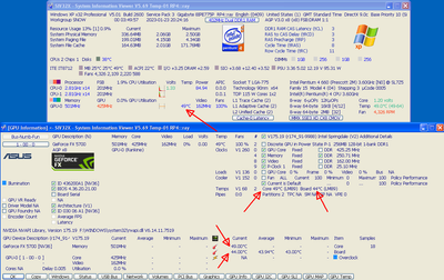

Reply 15 of 15, by red-ray
From SIV32X 5.69 Beta-01 temperature reporing works for my ASUS GeForce FX 5700 on Windows XP SP3, does it for your Gigabyte FX 5700?
file.php?id=155774
I also noticed my FX 5700 is running @ AGP x8, but yours was in PCI mode and am wondering why.
deksar wrote on 2023-01-15, 10:47:
Nvidia driver version: 53.04
Why an old version? The latest is ForceWare Release 80 81.98 December 21, 2005
