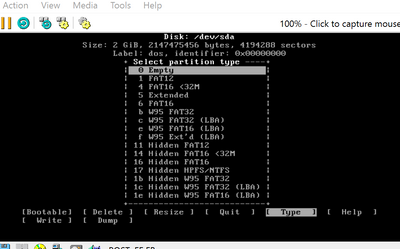

I was able to Install Windows 98 SE Quickinstall on a 86Box but for some reason, I have an issue partitioning a real disk on a real P4 System with the cfDisk Manager. I am able to create partitions but the software is unable to Detect/Format the Partition to Fat 32. There are is no Partition Type "W95 FAT32 (LBA)" . I see about 30 other partition types.
What is the issue?
Note the the HDD I am trying to install is 512GB SSD but I only create small partitions.

Hi,
The entry "c" is the fat32 LBA type.
CFDISK is somewhat unintuitive. After creating the partition you need to select "write" or press shift+w to write the partition table, else the changes will not be saved.
Then the installer will allow you to format this partition (CFDISK does not do this automatically).
Best
Eric
