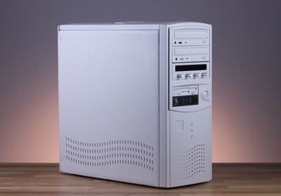

When I build a Pentium 4-powered Windows 98 rig for a friend, I got a little jealous of it´s performance and decided to start building one for myself, too.
Video links:
Part 1 - The Case: https://youtu.be/z_QwOb_2JA0
Part 2 - Hardware: https://youtu.be/TMmAt1kuyCE
Part 3 - Configuration: https://youtu.be/DB606N3tvQE

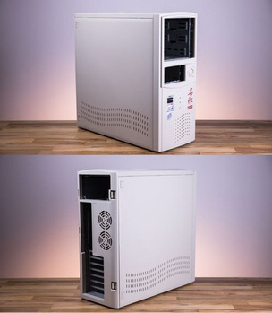

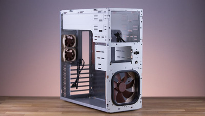

I needed a suitable case and found a gutted Meisaku Business case, which modified for better airflow (I may have exaggerated a bit...). I also ground and painted it, the metal frame included, just for fun.
38.75 KiB
1923 views
The case still intact
63.01 KiB
1923 views
The case modified and painted

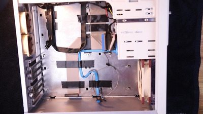

I wanted to try a little more finalized cable management than I typically do. However, these old cases are not manufactured with cable management in mind, so I had to get imaginative.
271.53 KiB
1923 views
Cable management under the motherboard

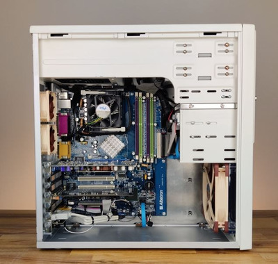

Mobo: Albatron PX865PE Pro with 3,2 GHz Pentium 4
GPU: Point Of View GeForce4 Ti4200sAGP 8x 128 Mb
Soundcard: Sound Blaster Audigy SB0090
Storage: 250 Gb Samsung 860 EVO in a 3,5" Icydock hotswap bay
RAM: 512 Gb to 2 Gb
66 KiB
1923 views
Components
And here it is finally all put together:
41.25 KiB
1923 views
Done
I think it turned out nicely.

I like the case, looks very tidy. I guess it has excellent airflow with those Noctua fans. The wavy grille pattern on the front and the side kinda reminds me of the Windows logo. And yeah, I know the feeling of wanting "just a bit more" performance, which then leads to an entirely new build. 😁
BTW, what kind of monitor will you be using for this system?

Yeah, the air flows quite nicely 😁 It would flow even better if I´d block the ventilation holes on the side-panels and get the I/O panel in its place, this would help pressurizing the case. My screen is a 20" 4:3 LG Flatron LC2000C. And yes, I would just love a good CRT but atm whis will do just fine.

I like the rubber strip around the hole cut for the front fan. Gives it a much less case hack feel and more professional, not something I'm very good at.
Love the cable management tape, that's more my style, zip ties and tape can fix everything 😉

Mobo: Albatron PX865PE Pro with 3,2 GHz Pentium 4 GPU: Point Of View GeForce4 Ti4200sAGP 8x 128 Mb Soundcard: Sound Blaster Audi […]
RAM: 512 Gb to 2 Gb
if it was for myself with those specs i'm not sure i could have stayed with win98, i'd have been tempted to win xp maybe with a partition for 98
it is, as you say, fairly top end for 32 bit era and very nicely done, will play just about any game that works on 98 for sure

I like the rubber strip around the hole cut for the front fan. Gives it a much less case hack feel and more professional, not so […]
Always impressed with your builds the hardware is well thought out and built to a high standard.

Easy way to hide blemishes 😁 The fan controller´s a Lamptron FC5 V2.
