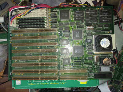

First post, by boroda
I got a motherboard without bios, bios from here
https://theretroweb.com/motherboards/s/ecs-sl486ve#downloads
gave nothing. I'm looking for a bios dump from the same, obviously working motherboard.
Thanks in advance.
Reply 1 of 14, by Horun
Hmmm.. inside that bios is the strings:
40-0100-001131-00101111-121291-SIS-EISA.
AMIBIOS (C)1991 American Megatrends Inc., ..SL486VE V1.0 02-22-93.
So it should be the correct bios.

That would be great if you could, also please specify the eeprom type/model. Thanks 😀
Also the board uses a DS1387 "ramafied" RTC and if like the DS1587 "serialized" for EISA will not allow a bootup if the battery is dead from my experience..

Like all of us. I bought it at a flea market ... Yes, maybe so, but usually bios are removed for collection. I already desoldered Dallas, today the socket should come by mail, i will solder socket for Dallas. Repair to Dallas i already did, there was 3 volts, now 3.6 volts.
Reply 8 of 14, by PC Hoarder Patrol
boroda wrote on 2023-01-30, 14:15:
Yes!!! It was dead Dallas. Now the motherboard has started, so the BIOS is correct. )))
Glad you got it working again 😀 (was pretty sure my BIOS version was the same as the one on The Retro Web anyway) - if you need the EISA config app / files for the board, let me know

Yes, i'll try to take a photo tomorrow. And for not to make legends. I also found that my oscillator held in the socket miraculously. Perhaps Dallas did not require repair. But this action did not get worse and he now stands on the socket.
1.04 MiB
517 views
P.S. Pentium ODPR 83MHz runs ok.
