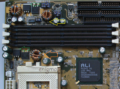

Reply 1 of 42, by fool
I would measure these two regulator output voltages. You can do it without CPU. Just check that Vcore jumper is set to something, like 2.1V.
Orange = Vcore
Yellow = VIO
Green = 5V reg input
    861.89 KiB
    982 views

Reply 2 of 42, by Nemo1985
Thank you for the tip, I can do it straight away I just have 2 dumb questions:
Orange arrow measured v1.42 (it started from v0.8 and slooooooowly went up).
Yellow arrow measured v1.47.
That with v2.1 voltage setting, same values if I use an higher vcore setting.
Where could be the problem? Capacitors?
Reply 3 of 42, by fool
Orange is Vcore and 2.1V is OK. But I was wrong with the CPU, for VIO (yellow arrow) measurement CPU must be inserted. Otherwise they are about the same value.
Also try to change GND point if value looks strange.
What CPU are you using?

Reply 7 of 42, by fool
Regulator inputs should be 5V, measured from transistor tabs. Green arrows in edited picture.

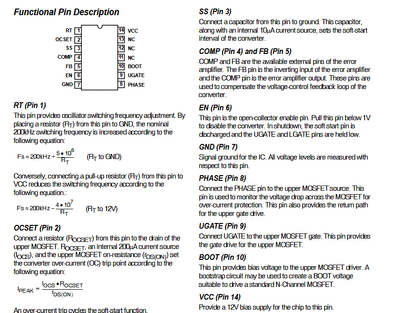

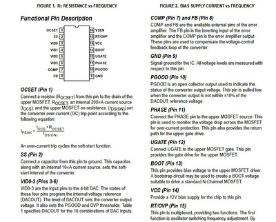

Reply 16 of 42, by Nemo1985
Uhm i'm sorry but i'm not so savy when I have to use the multimeter, so I need some clarifications.
Should I touch every pin with the red probe while the black is on the ps2 ports case and check resistance?
That with the motherboard turned off?
Those are taken from the datasheets:
140.76 KiB
864 views
62.52 KiB
864 views

Values for HIP6008 values from pin 1 to 16:
>3k
10.78m
23.48k
0.3
7.53k
4.881k
10.85m
11.90k and then goes up
0.2
9.70m
55.06k
7.91m
38,06k
38,06k
9.81m
First time Goes up to 55k and then down, remeasured gave 2m and goind down
Crazy means that the multimeter start with a low value and then it goes up up up up, while the other are like stable value (they may change of 0.01)
HIP6013:
10.30m
6.13km
11.26m
0.L
3.605k
13k
0.3
453
7.87m
38,05k
0.L
0.L
0.L
38,05k
