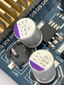

Whilst removing a FX 5900xt from a tenacious hidden AGP clip, I worked a capacitor loose from the bottom of the board.
I ended up pulling it off completely. Can anyone identify this? If possible a link to mouser or other retailer of a replacement would be appreciated.

It's a surface mount 180uF 16V aluminum polymer capacitor.
You'll want to get a replacement cap with the same specs, but also the same height/width (package size). Then it should be a matter of desoldering the damaged base and soldering the new one in its place.
You also want to be careful when removing the base that you don't accidently rip up the underlying pads. Hence, I would suggest desoldering instead of trying to pry it off.

Not this one.
180uF 16V polymer due to purple marking set it apart from others.

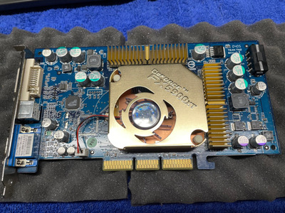

Well I got the new cap and replaced it. Continuity test with a multimeter shows good connections from the pads either side of the new cap, but still cant get the system to even power on with this card installed (System works with a Radeon 9700).
I'm not getting a continuity test across some of the other caps towards the top of the board. I think this card may be toast, or beyond my ability to repair. 🙁

Can you provide a full high resolution pic?
PC#1 Pentium 233 MMX - 98SE
PC#2 PIII-1Ghz - 98SE/W2K
- Bare metal ist krieg.
Reply 11 of 22, by JayAlien
Of course, here it is.
Ah, I had to lower the resolution a little for the 2mb limit
EDIT - I tried this GPU in another P4 system and same behavior, a momentary pulse of all the fans but no boot. Putting the Radeon 9700 in this second system booted just fine.

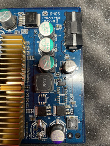

By the looks of it, those 2 purple caps are on the 12V input for the vrm from the molex connector . If you have a good PSU and the video card is fine, it should boot/work without both of them. Use a multimeter and check for continuity between(without system power) the yellow molex wire (12V) and the unmarked pins of the caps(they have 2 pins one is not marked an the other is marked by the purple shape from the cap. Then check so you don't have continuity between the 2 pins of the cap, then with the multimeter set to voltage mode and system powered on check again if you have 12V between the 2 pins of the caps(be careful not to short something).
I get continuity between the yellow molex and both sides of both the purple caps.
I do have continuity
So I have a short perhaps?
I haven't tested for 12v across the caps yet, but if I have a short not going to see a voltage across the caps....
EDIT - I have continuity between the yellow molex and both black cables. I've got a short.
EDIT 2 - I removed the cap I soldered on in case I'd created a solder bridge, and cleaned the pads. With the cap removed I still have continuity both across the empty pads and across black/yellow at the molex connector.

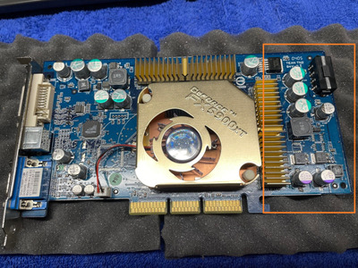

Reply 18 of 22, by bogdanpaulb
Post a high res pic with the area selected (front and back).
Reply 19 of 22, by JayAlien
Thanks for looking, here are the images
