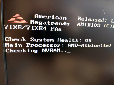

Slot A is one of my favorite platforms. But now I am out of ideas. I think I swapped every component I can think of. This Gigabyte GA-7IXE board is stuck at a well known BIOS POST line:
Checking NVRAM.._ (underscore keeps blinking)
So, the NVRAM is in fact inside the BIOS chip right? I swapped that one too.
A complete list of exchanged components:
-Processor, Argon 600, Pluto/Orion 700 and a TB 1000.
-Power supply
-Memory, multiple DIMMs, from old and slow PC100 stuff to new PC133 CL2.
-The SST BIOS chip , tried a same size Winbond (256kB), BIOS versions F7 and FAa (beta). I flashed them with my beloved TL866II, default settings when programming. I did a full erase and read, goes well with both chips.
-Video card(s), I tried AGP, PCI and ISA cards.
-CR2032 coin cell battery, checked with a volt meter, 3.31 Volt.
And I reset the BIOS multiple times and checked that jumper dozen times.
Is this board ready for getting dumped and potentially being found by another Vogoner so he/she can post it in this topic?:

PD2JK wrote on 2023-02-09, 11:02:
Yes, should be the bios chip. Your post reminded me of this Twitter post (https://twitter.com/nanochess/status/16201538 … BDhQXuiMjC1BFWg) where the author fixed similar issue by replacing the bios chip. Was your replacement bios chip new? Maybe it is broken too.
Reply 2 of 3, by PD2JK
I found a few 512kB chips, but they don't work in the board.
Is there a special way to flash 256kB ROMs in higher capacity chips? Or does the mainboard expect a 256kB ONLY?
Reply 3 of 3, by Roman555
PD2JK wrote on 2023-02-09, 15:17:
Are those 512kB chips EEPROM (not FWH nor LPC) ?
If address line A18 of PLCC32 socket is disconnected from mainboard then you can just make a new image for a 512KB flash chip concatenating the two 256KB original images.
copy /b bios.bin + bios.bin  double.bin
If the address line A18 is connected then a pin A18 of a BIOS chip should be isolated from a PLCC32 socket.
All in theory : I've never done it by myself. Because EEPROM chips might have different structure of inner areas. So look up datasheets.
P.S. Is FAa (beta) for GA-7IXE4 compatible for GA-7IXE ? I've seen the latest version for GA-7IXE is F7 Ok, I see FAa version in TheRetroWeb
