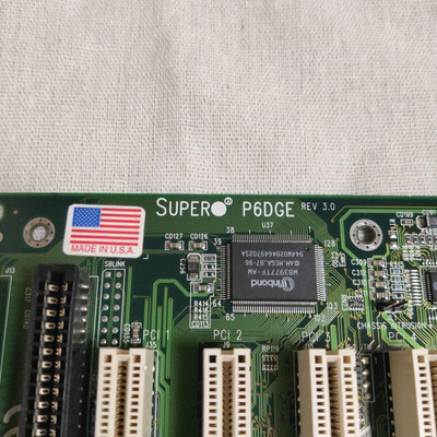

I was wondering if anybody could me with some information about the Supermicro P6DGE Rev 3.0
Does anybody know if the SBLINK solder pads on the board are for SB-Link and if so, what is the pinout? I'd be willing to try to trace the traces once I receive the board. It's currently in shipping. I understand that I'll probably have to rig up an unconventional connector to make it work since it's not the standard layout. I've attached a picture of the pads. In the manual, it is just labelled SBL.

SBLINK Pads on PCB

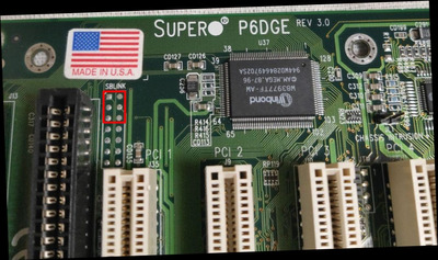

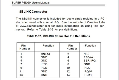

Must be an old manual - my P6DG family manual clearly says SBLINK for all the different models (I have a P6DGU and a P6DBU with the same solder pads). SM boards tended to share common elements, so I suspect this pinout from the P6DGH will work...
88.52 KiB
653 views
Processor-wise, I never had much luck with dual slockets (ABIT & MSI with 2 x SL5QVs) on my boards, but they're fine with dual Slot 1 coppermines (100 & 133MHz versions - there's even a BIOS switch to allow the 133s to run at the full 1GHz). VRM-wise you're good with the HIP6004BCB - this link has more info on that and terminator cards for single coppermine use... https://web.archive.org/web/20030202061308/ht … s/Processor.htm

I've seen this "extended" SBLink connection before on an ESS Solo IIRC. Pay attention to only these pins, and it should function like any other SBLink:
177.17 KiB

Thank you to PC Hoarder Patrol for sending that diagram over. Hopefully, I can rebuild the SB-Link connector with that.
