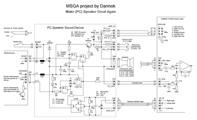

Hi all!
In order to play older games that don't support soundcards and only use a PC speaker, I connected the output of the speaker on the motherboard to the PC_SPK AWE64 input. This led to a sharp increase in noise at the output of the sound card, as a result of which I had to remove the gain at the speaker input with a mixer and increase it again if the game required a speaker. I got fed up with it and decided to do something.
A brief study of AWE64 showed that noise and interference at the PC_SPK input are inevitable due to the very simplified Creative solution. In effect, the input, with little filtering, is connected directly to the +5V rail of the motherboard, with all its powerful noise. Even worse, this input does not have a ground pin, which means that it is simply impossible to get a low noise level at this input. The good news is that the TAD and PC_SPK inputs are essentially the same input, which means that the TAD input can be used to connect a speaker while still allowing the mixer to adjust the signal level. In the absence of the TAD input, you can use the CD_IN input, and if the CD_IN input is occupied, then it is desirable to keep the ability to use the PC_SPK input, trying to reduce the noise level.
In my opinion, the only cardinal way to get rid of interference is the use of optical isolation. In order not to mess with a galvanically isolated power supply, which in itself is a source of interference, I decided to use the photovoltaic effect in a pair of LED - photodiode. The experiment showed that a photodiode loaded with a resistance of 1 kOhm develops a voltage of 0.45 V on it and has sufficient speed for our purpose.
I did not want to lose the opportunity to hear the caressing ear of BEEP at the start of the computer 😀, and at the same time I needed to ensure silence during nightly games with headphones. Therefore, I implemented a timer that turns on the speaker for 30 seconds after the power is turned on or when the reset button is pressed.
The use of the timer entailed the use of its own speaker driver, and since I added a driver, why not give it additional features.
Thus the PC Speaker Sound Device was born.
The following application modes are possible:
1. We connect only the speaker and set J1 to the Enable position. You can connect a useless switch Keylock or Turbo (if it is not used) to J1, in which case it becomes possible to turn the speaker on and off as needed. This mode corresponds to the standard use of a speaker with a peak power of 120 mW (8 ohm speaker). You can also jumper pins 1-2 of the CN5 connector and get a maximum peak output power of 315 mW. Or connect a potentiometer and be able to adjust the volume from 0 to maximum. This mode also allows the speaker to be used on motherboards that are designed to use a piezo buzzer and have a high internal resistance of the output driver, as a result of which a standard 8 ohm speaker sounds too quiet.
2. Everything is the same as in the previous mode, but we connect the output of the sound card amplifier to the AMP_IN input. This allows you to use sound cards that do not have any sound inputs at all (for example, Adlib). In this case, it is better to install a speaker with a larger diameter for better sound quality.
3. Connect the speaker, connect the sound card to the LINE_OUT or PC_SPK output and set J1 to Auto. In this mode, the speaker will be connected for about 30 seconds after the power is turned on or the reset button is pressed, allowing you to hear the start-up BEEP or alarms if something happens. In games, we listen to speaker sounds through stereo speakers connected to the sound card.
4. Everything is the same as in the previous mode, but we connect the output of the sound card amplifier to the AMP_IN input and use only the built-in speaker in mono mode.
Before making a prototype of the device, I would like to ask your opinion about it. What other useful functionality could be added? Maybe all this is superfluous and only the basic possibility of a low-noise output is needed? Criticism and suggestions on the electrical circuit are also welcome.
Thanks for support.

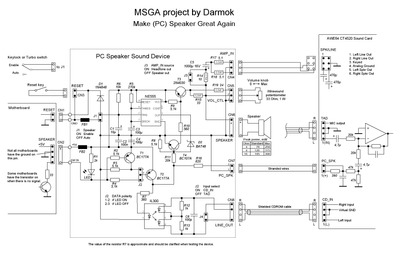

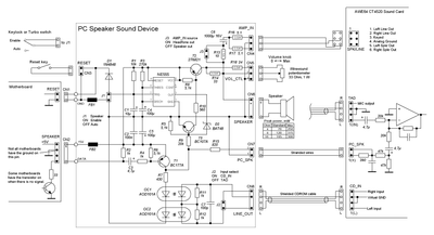

Update: I have made changes to the circuit based on the results of testing the device.

Reply 1 of 24, by Jo22
Hi there! I really like your design, kudos! 😎👍

@Jo22 You describe a method for regenerating the shape and amplitude of a signal, which is used when transmitting a signal over long communication lines and its inevitable degradation. In our case, this does not happen, on the contrary, we need to convert the input signal into a form acceptable for the sound card.
The speaker PC signal is a PCM binary signal with an amplitude of approximately 5V. The transformation of this signal into sound occurs directly in the speaker itself due to its mechano-acoustic properties. If you apply this signal to the input of the sound card, lowering its level to a standard value of 1V, then it, having passed through the audio path and the amplifier, will be restored again to approximately the same initial level and, having reached the speaker at the output of the sound card, it will also be converted by it in sound. If the sound card had infinite bandwidth, the output signal would be exactly equal to the input signal, but in reality this is not the case and the sound card introduces distortion into the waveform. From this it is clear that there is no point in preserving the exact shape of the signal at the input of the sound card; rather, on the contrary, it is better to narrow its spectrum to reduce intermodulation distortion.
By the way, the question of whether the sound card strongly distorts the speaker signal is quite interesting. I experimented with two identical standard 8 Ohm 2" speakers and connected one to the output on the motherboard and the other to the output of the sound card amplifier and placed them side by side on the table. Running a tune from the Supaplex game and leveling the volume of the speakers, I tried to determine if they sounded much different. To my non-musical ear, the speakers sounded exactly the same.
The speaker's input level is so much higher than the interference level that it is effectively masked by the signal itself, so the problem is not that interference is superimposed on the signal, but that interference is present when there is no signal. The signal source is connected to the 5V bus and ground on the motherboard, which are the source of interference, as long as such a connection exists, interference cannot be eliminated. The only way to break this link is optical isolation.

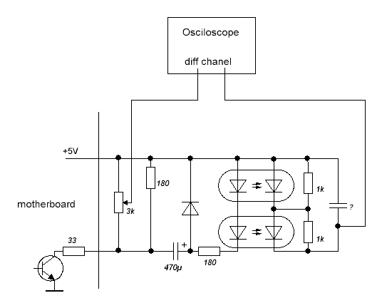

Well, I agree that the phrase "The only way to break this link is optical isolation" is not entirely correct in the general case. There are other devices for galvanic isolation. Electromagnetic transformer, piezoelectric transformer, magnetostrictive transformer, electromagnetic relays, etc. In most of these methods, including optical isolation, active devices are required to restore the waveform and, accordingly, a power source. There is only one power source in the computer, from which we want to get rid of interference. You can use a galvanically isolated converter, but this will greatly complicate the circuit, in addition, such a converter will itself be a source of interference that you will have to deal with.
For this reason, I chose a method based on the photovoltaic effect. This solves the problem of signal regeneration, it is simply not needed. The photodiode gives a voltage of 0.45V at a load of 1 kOhm, by connecting two photodiodes in series we get a voltage of 0.9V, which corresponds to the required standard level at the input of the sound card.
Unfortunately, a circuit based on the photovoltaic effect has a limited speed. I don't have a Vishay IL300 Linear Optocoupler at the moment, so I was experimenting with an ancient optocoupler with much worse parameters and only one photodiode. I have an oscilloscope, but no tunable square wave generator, so I used a 5 kHz fixed frequency generator. The results were satisfactory, there was a slight drop in signal fronts, according to my estimates, the circuit will be able to work up to frequencies of 10 kHz, which is quite enough for our purposes. The bandwidth can be increased by lowering the load impedance, but this will lead to a large drop in signal level. In any case, only the manufacture and testing of a prototype will show the possibility of using this solution in practice.

The speaker's PC signal source is connected to the digital ground on the motherboard and the +5V power rail. The noise source is both the power rail and the digital ground. Interference on the digital ground occurs as a result of the action of powerful current pulses flowing through the ground bus. The internal resistance of such a noise source is about ten milliohms. How can you filter them out? The use of a logic gate will not help this in any way, nor will a good power supply, since the signal at the output of the gate will also be tied to digital ground. Connecting digital ground to analog ground at the input of a sound card is a bad idea. Sound card developers specifically take steps to somehow decouple these two grounds to reduce interference. This can not always be done efficiently enough, so special solutions are used to obtain noise-resistant sound inputs. Such an input, for example, on Creative sound cards and many others is the CD_IN input. If you try to measure the resistance between the ground at the CD_IN input and the analog ground, for example, at the TAD input, with a multimeter, it will show a fairly large resistance. This is because the ground at CD_IN is not a "real" ground, but a virtual one. In fact, this is the output of an operational amplifier involved in a special circuit solution that, in theory, completely eliminates common mode noise. In reality, due to the non-ideality of electronic components, it is not possible to completely eliminate interference, but it is possible to significantly (by orders of magnitude) reduce their level.
In my device, optical isolation does not serve the purpose of protecting the sound card from short circuits or anything like that, but only to decouple the signal source from the digital ground and thus from the source of interference.

Reply 18 of 24, by Darmok
I made a tunable square wave generator with adjustable duty cycle and tested the optocoupler in photovoltaic mode.
Last time I was too casual about the experiment by setting too much current through the LED. As it turned out, there is an optimal current value at which maximum performance is achieved. For the optocoupler I used, this current was 6 mA. In this case, the minimum pulse duration at which its full amplitude is maintained was 7.5 microseconds. The duration of the leading edge of the pulse is weakly dependent on the current through the LED and has a duration of 2.5 microseconds. The duration of the trailing edge at the optimum value of the LED current is 5 microseconds. As the LED current increases, the trailing edge duration increases rapidly. Reducing the current below the optimum leads to a decrease in the signal amplitude.
The limiting frequency that the tested optocoupler is able to pass without reducing the amplitude of the output signal is approximately 65 kHz. A decrease in amplitude of 3 dB is observed at a frequency of about 70 kHz.

I also developed a new version of the device circuit using logic gates. I have not used power supply filtering as I find it unnecessary and useless. I invite you to express your opinion on this option.
The values of the resistors that set the duration of the timer and the current of the optocoupler LED are approximate and require clarification when testing the device.

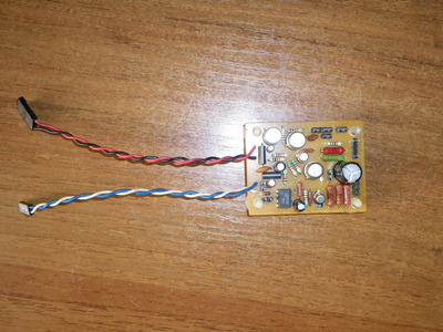

Reply 19 of 24, by Darmok
Since I don't have the 74HC132 and IL300, and it's too long to wait for them to arrive, I made a version with transistors and AOD101A optocouplers. An excellent result has been obtained. Having set the maximum signal level, I connected and disconnected the LINE_OUT output to the input of the sound card, while comparing the noise level at the amplifier output. No additional noise was detected at all. Similarly, I checked the output of PC_SPK, there was an extremely small little noticeable increase in noise. The sound quality when using LINE_OUT is excellent and does not differ in any way from that obtained when using PC_SPK. The photovoltaic circuit is quite usable. The rest of the device works as it was designed.
