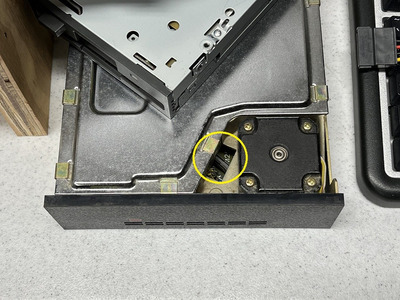

I found an old 1/2 height Tandon TM252 MFM drive and an 8 bit controller. It's a venerable member of the generation of drives that fit "Drive Type 1" in the bios.
I was trying to get it to work on a Formosa Industrial UB-320SAI motherboard.
The motherboard didn't seem to get along with the 8 bit controller so I pulled out a WD 1006V-MM2.
Still didn't work. The drive would spin up fine and flash a light, but then it would give a sad grunt, and the mobo would throw a disk error.
The drive sat around for a month. Or three. Couldn't bring my self to throw it out. Didn't know what to do next.
Today I started poking at it again. I noticed that the actuator arm was visible through a hole by the motor and the "sad grunt" corresponded with a slight twitch in the arm.

I powered down, moved the drive arm a little with a flat head screw driver and when I powered it on, the drive came back to life! Yay!!
Pretty sure changing controllers caused any old data to be unreadable, but I was so excited to finally able to use those low level format routines in the BIOS for the first time in my life that I didn't care. Later I kind of wished later that I had slowed up a bit, just to see what was there, but whatever. That time has passed. Interleave testing!! OH boy. I remember people talking about that when I was a teenager. If I ever did these steps before, I've long forgotten.
Anyway, the drive is all formatted, error checked and ready to go now.
