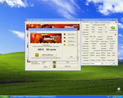

Seem's that a normal Nvidia FX5200 can use DDR2 VRAM without an issue. Still working on the memory layout , the ic's that i put are 16X16 (256Mb) but the card uses them in a 8X16 (128Mb) config.

That's actually really interesting. It seems the Asus 7600GS uses 400MHz TSOP GDDR2 - is 275MHz all you could squeeze out of the memory chips on the 5200 PCB? What about memory timings? The GDDR2 chips should in theory use higher timings - what about to increasing memory timings as well, then have a go at raising the clocks? What about voltage? Wouldn't the GDDR2 chips run at lower voltage, or do they run at a similar voltage due to the higher clocks? (then again 400MHz isn't really that high for DDR2). What did you use the salvaged caps and resistors for?

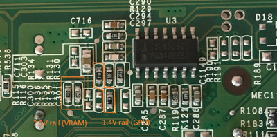

The Asus card had HY5DU561622ETP-4 ic's, they are gddr2 500 Mhz(250mhz effective), divide that by 2 (same as the speed of the ddr2 ram in CPU-Z is divided) and you get the actual frequency. What you see in the GPU-Z memory speed tab has to be multiplied by 2 to get the 'commercial speed', so i got some extra 50Mhz(25mhz real).

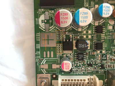

It has some small volt mods: the stock mem ic's were dual voltage gddr chips (3,3v and and 2,5v) so i moved around some resistors to get only 2,5v (that's what HY5DU561622ETP-4 like). Then i had to mod the voltage regulator because i was getting 2,41v (2,45v) so got it to 2,58v for the memory and for the gpu die from 1,38V (1,4v ) to 1,56V. All had to be done at a hardware level, it can't be controlled via vbios.

The formula for the voltages in both cases is: V = 0.8*(1+Rx/Ry).
