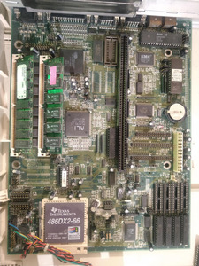

I got some cache chip from aliexpress (32K * 😎 to add 256K worth of L2 on my 486 but I can't get it to detect it.
Board is not much documented, it have jumper for selecting 128k or 256k. But I could not find any other jumper to set (like to turn it on) and there is no option for that in the limited BIOS (I see something like "Cache [Enabled]" but I can't go there to change that option (it's read only).

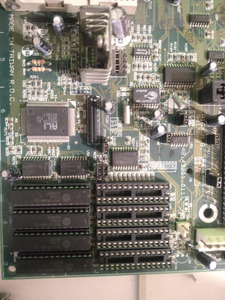

Also I did notice two unpopulated transistor near the cache bank, could they be required to get them to work? I did find only one other picture of a A1GX-1 board that have cache and have the transistor populated.
I did attach the picture, if someone can help me.
I would assume that if I got defect from aliexpress it would crash or do funny thing right, not just not detect any?
I did try with 128K (as in the picture) and the full 256K.
I did find "documentation" here : https://stason.org/TULARC/pc/motherboards/A/A … GX-2-CACHE.html

    Near the cache sockets, we see missing transistor.

Reply 1 of 8, by Rav
I did some test I took from ASUS VL/I-486SV2GX4 Rev 1.7 l2 cache problem
The different lines between the chips in same bank and different bank that should be parallel are parallel.
Voltage for all the chips is 5.03v.
Could not test down to the tag chip as that one is in the middle of the board and there is 3 buffers chip by the sram banks...
Will do a more extended test this weekend and also go to a big city to see if I can find sram there, in case i'm lucky..
Fun fact, I noticed that the rtc was not working when the ISA riser was not connected, like the seconds, don't even change when the system is on.
I did do all my sram test without that riser connected, I don't think that could affect the cache but maybe I should test with the riser installed just in case...
I was also able to gain access to the disabled option I mentioned earlier by moving a jumper "OEM bios / Acer bios" back to Acer. only difference is that it show an acer logo and give me access to the read only option, but nothing related to the L2, the cache option was already enabled but maybe it was just for the L1.
Reply 2 of 8, by jakethompson1
Rav wrote on 2023-02-24, 02:11:
Hello!
Do you have a TL-866 II? It can test SRAM chips, and highly recommend it if those chips are untested. A lot of us use those 128kx8, 32-pin chips we can only get from eBay in our boards that can handle them, and it seems about 10% of those that you get are bad.
Those cache size jumpers don't actually tell the BIOS anything about how much cache is installed. All they do is redistribute address bits between the tag RAM and the cache data lines. On all these old 386 and 486 boards, the BIOS determines the cache size by putting the chipset into a special cache test mode, writing patterns (0x55AA/0xAA55 etc.) into memory, and seeing what sticks. So if a cache chip doesn't respond at all or always returns bad data it's the same as a missing one.

Reply 5 of 8, by Rav
Problem solved.
I made that arduino sram tester and modified the program so it do full random fill then read it back then AA55ing the whole sram again and read it back again.
Weeded out 4 of the 10 chips, 40% defects!
Now running only with 128K only so I downgraded the ram to 16MB for now so it's fully cached.
Have to order more of that half dead sram!
