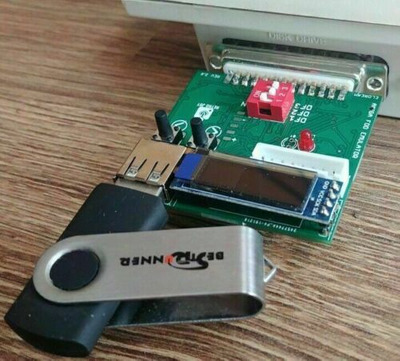

For a non-original replacement, I recently saw something interesting while browsing around:
44.31 KiB
206 views
That's a Gotek / OpenFlops that runs FlashFloppy, I think this was made from the OpenFlops design but made to fit the Amiga. It'd be pretty interesting if there was a similar project for the weird shapes of slimline floppy drives that could also run FlashFloppy 😀 (I want to do this now, I just made a PCB adapter to convert a weird floppy pinout to standard pinout)

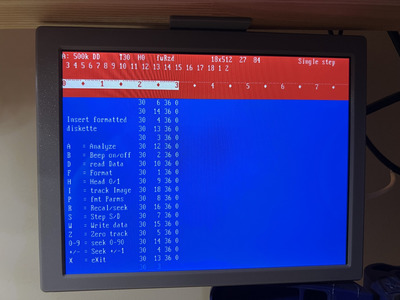

To test the drive out you really need a tool like IMD: http://dunfield.classiccmp.org/img/index.htm
  • It's used in DOS and you press Esc on starting to get to the real menu though it doesn't hurt to read the documentation that shows first
  • Insert a known good floppy disk either a new one or one that was formatted on a known good drive that has no trouble reading/writing
  • First test out the RPM with 't' and press Enter to start the test, it should detect a 500K DD disk and 300RPM. Let it run for a bit to stabilise
  • If that's okay, go into the alignment tool with 'a'. Press Enter to start and it'll start reading whatever it can identify from
  • Press 0 to move the head to track 0 and see that it reads as being on track 0. It should look like this:
    683.54 KiB
    165 views
    The "36 0" at the end indicating that 36 sectors are read and none not-read.
  • Press 7 to step the head to track 70 and the head should read from track 70. The number being read will go down briefly until the disc has turned fully but it should stabilise after that.
  • Press 'h' to switch which head you're reading from, that should also read "36 0" if it's good
  • Press 'r' to recalibrate the head position, this moves the head back to track 0 then back up again
  • Press 0 to move the head back from 70 to track 0
  • Go back to 7 and see if it's okay on Track 70, then press '+' to step the head one track at a time. Go up to track 79, the last track on a 3.5" DS-HD
  • At this point if that all worked, I like pressing 'r' a few times to have the head seek from 79 to 0 and back again, that has freed up the head on a direct drive floppy that I was testing the other day that was having trouble reading things
If you see the drive shows numbers less than 36 on a regular basis, or the drive can't detect what type of disk is inserted, there might be some bigger problem with the drive. Although I use the IMD alignment tool for testing drives, actually aligning the drive with track 0 and aligning heads is something I really recommend against doing anything with initially. At that point it's worth considering the cost of a replacement drive if they can be found easily.
