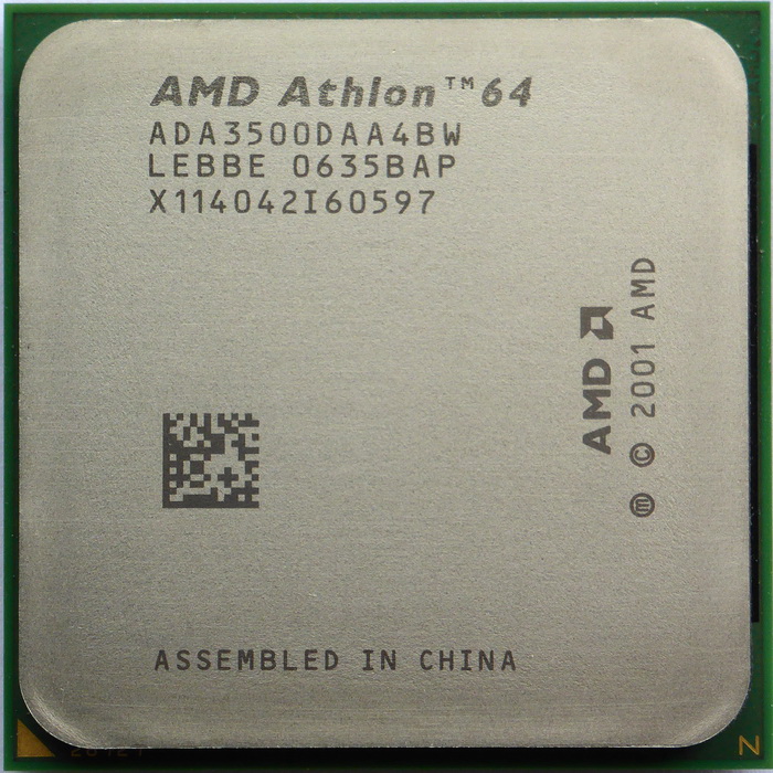

CPU: Athlon 64 3500+ Venice Socket 939 (I bid on an AMD Athlon 64 X2 4200+ Manchester)

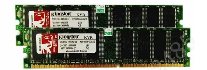

Memory: 2GB 2x 1GB PC3200 DDR 400Mhz 184Pin DIMM RAM Desktop Memory KVR400X64C3A/1G

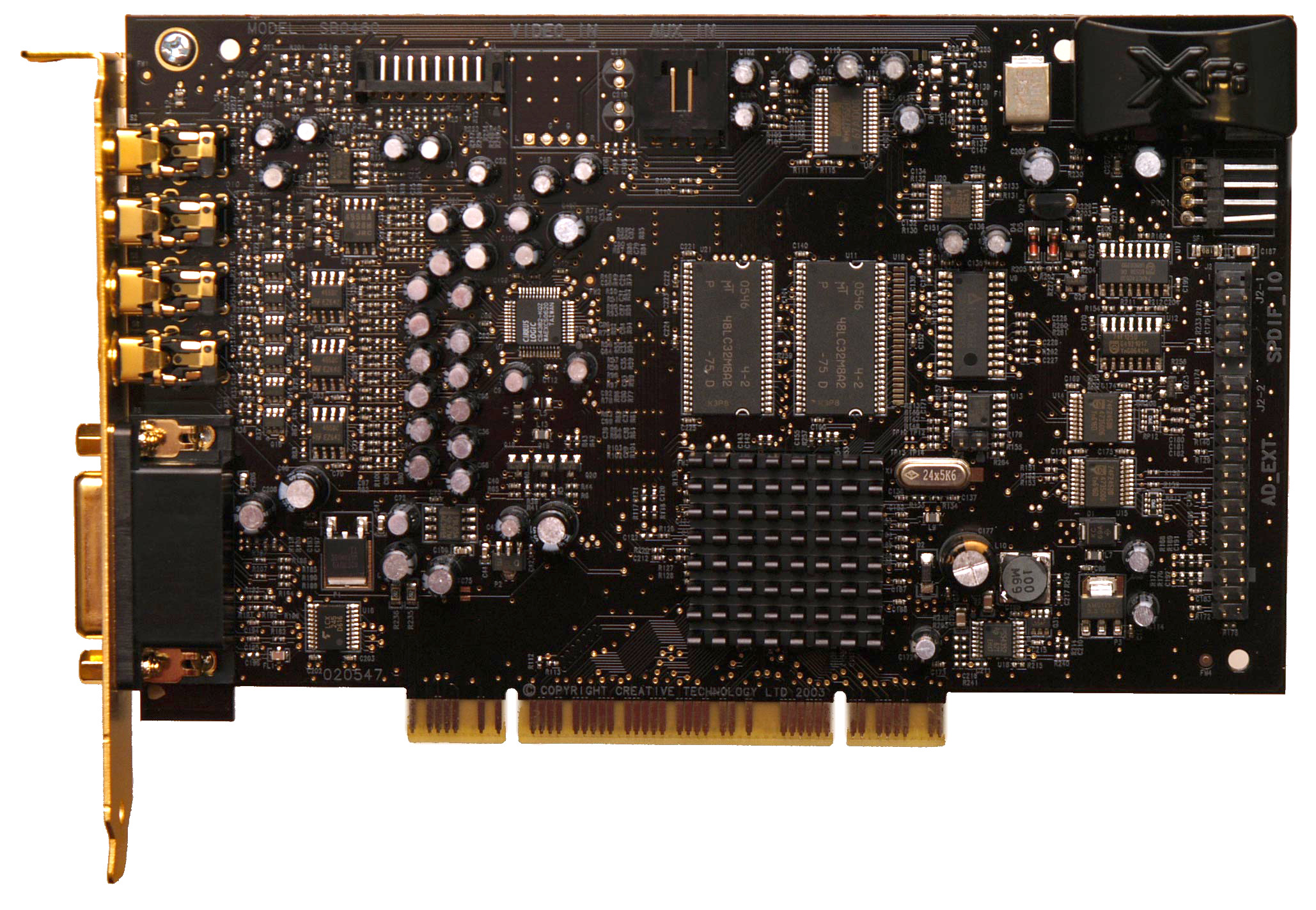

Sound: Creative Labs SB0460 X Fi PCI
FpsYlsPXsAA6AaV?format=jpg&name=4096x4096

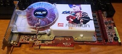

GPU: Ati Radeon x1900 xt 256mb pcie. I Will probably use Omega drivers based on Cat 7.1.

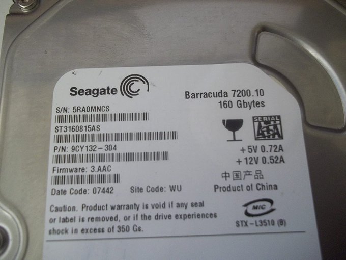

Storage: Seagate BarraCuda 7200.10 ST3160815AS 160GB 7200 RPM 8MB Cache SATA 3.0Gb/s 3.5"

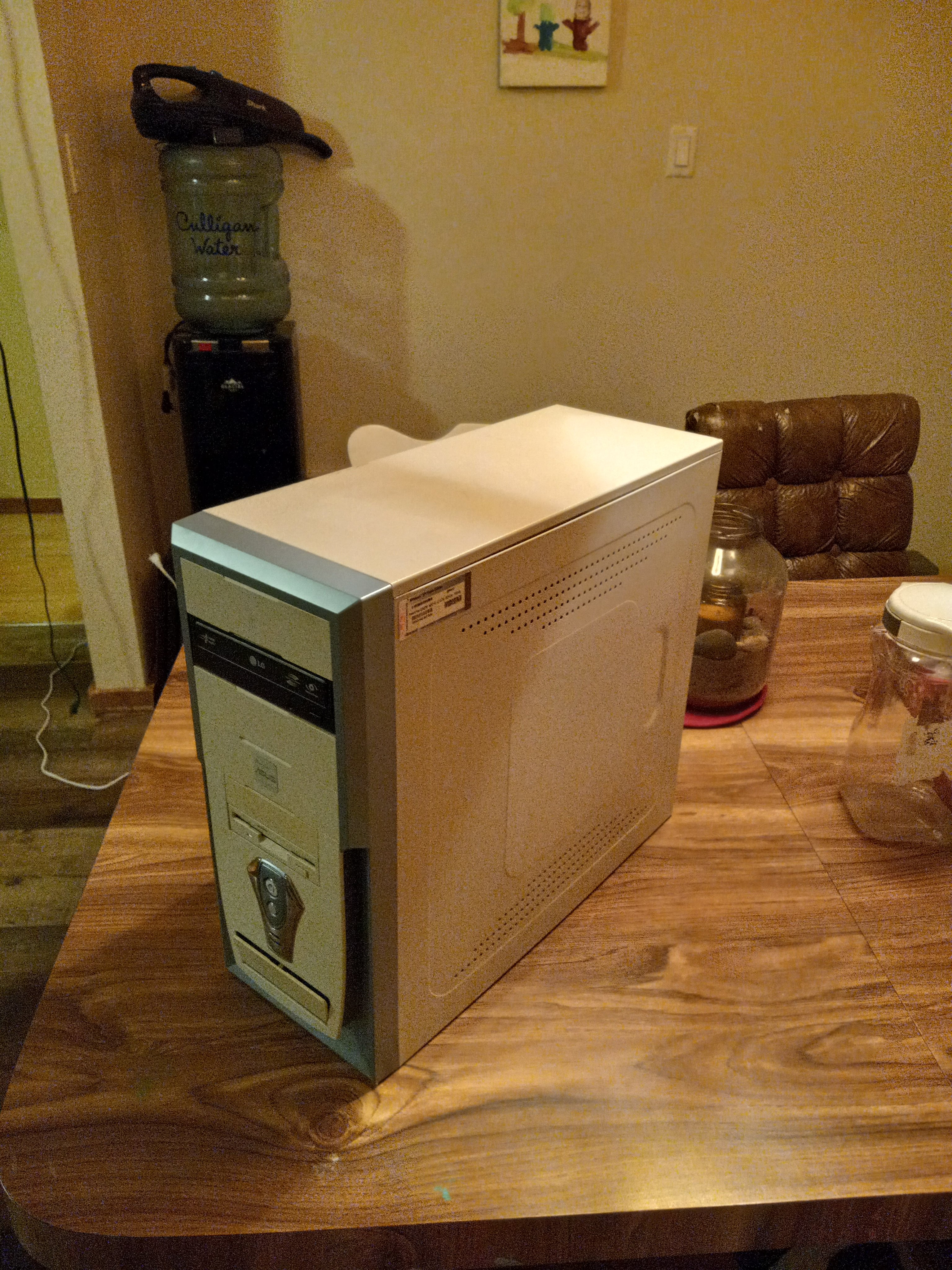

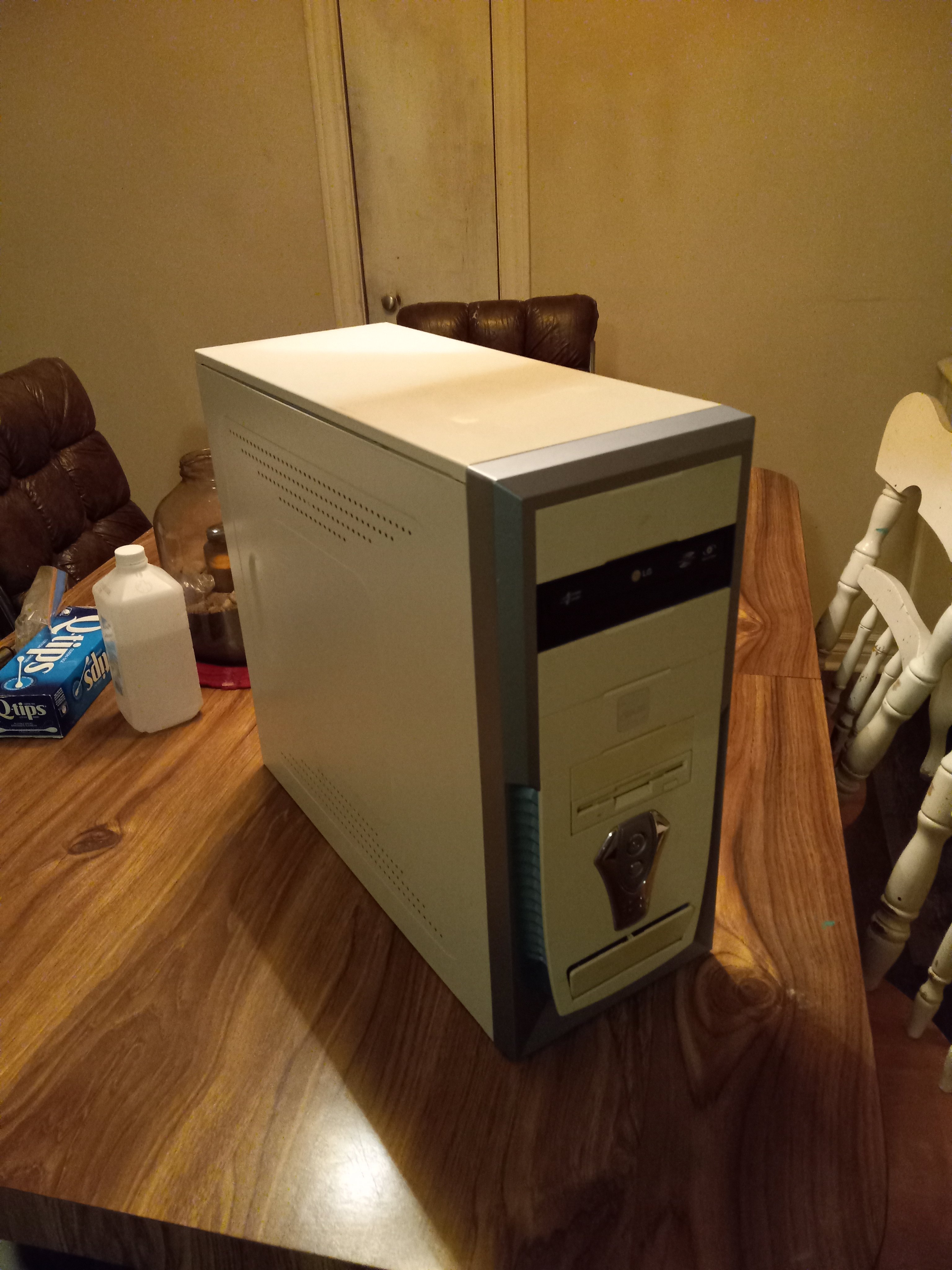

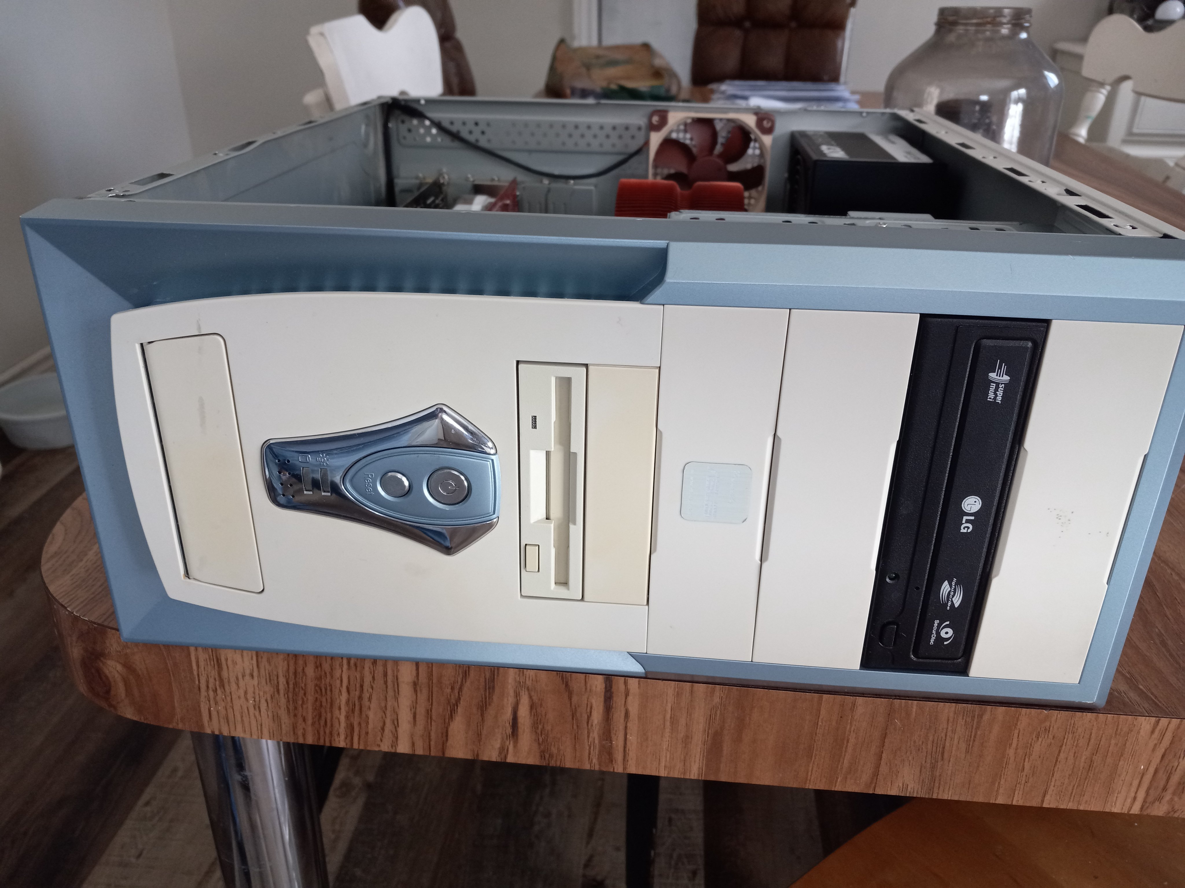

Chassis: FpsdUIgWcAAhqrQ?format=jpg&name=4096x4096 Fpsdb5_X0AEPLCh?format=jpg&name=4096x4096

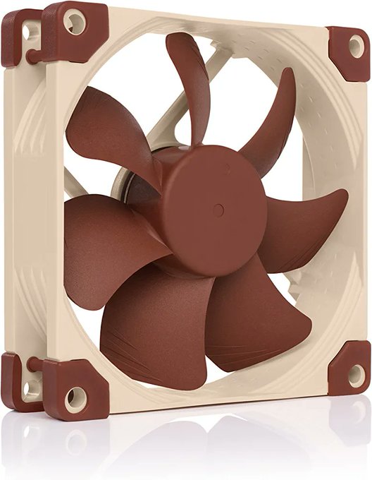

Cooling Chassis: 92mm fan for the rear of the chassis. Noctua brand, 3 pin.

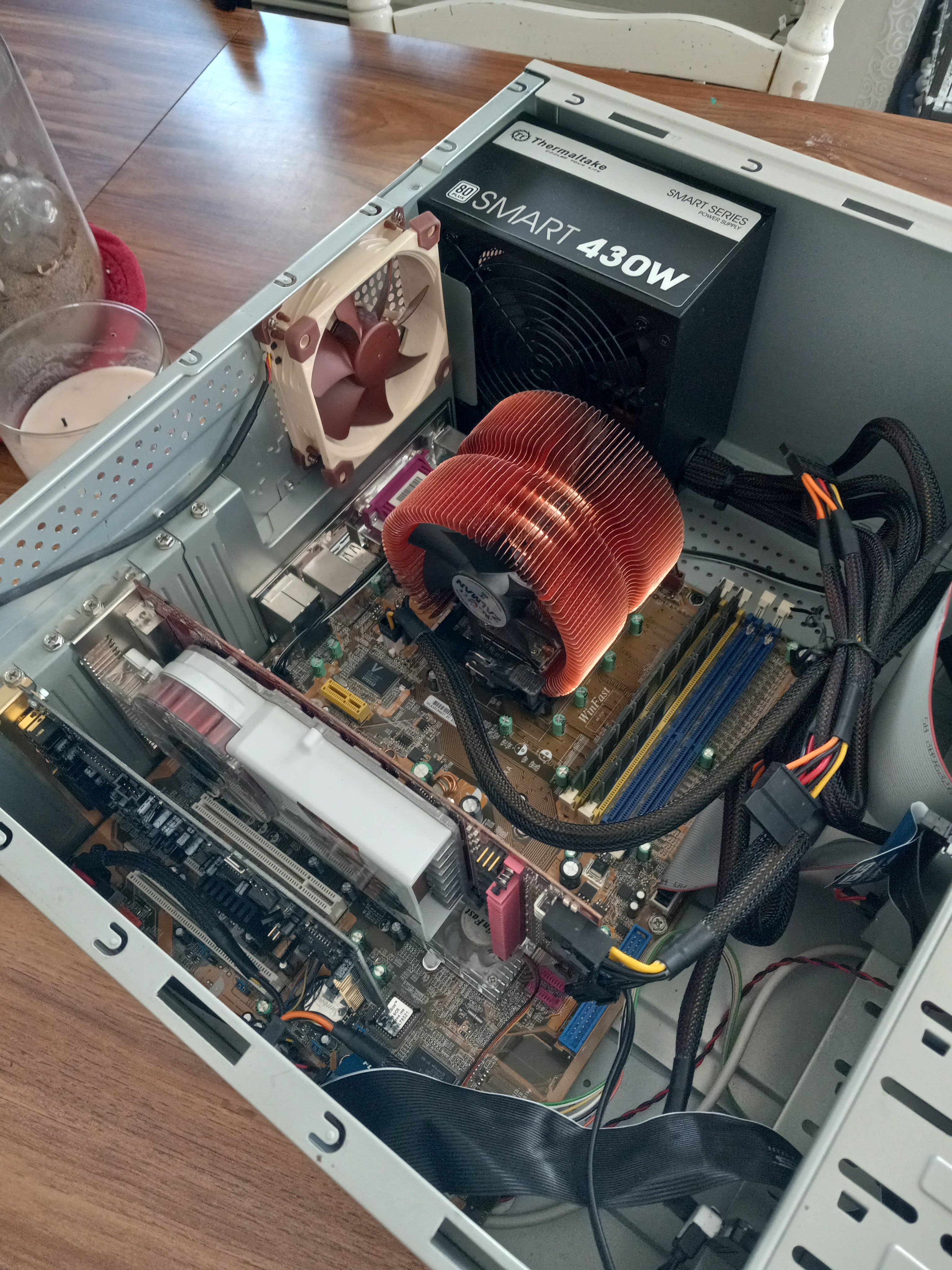

Cooling CPU: Zalman CNPS9500AT
FpxywwkXoAEfqRK?format=jpg&name=small
I bought the Zalman CNPS9500AT last year because it was supposed to work with a Socket 478. Of course the parts no longer come with it. However I was able to jury-rigg this thing using parts from my stock 939 cooler for my Athlon 64. Temps went from 40 at cold start to 22-25.
Some oddities of note on the motherboard: The nforce4 ultimate chipset has a heatsink with a mounted fan. There is also an auxiliary Molex connector for pci-e. These quirky features where only around for a short time as far as I know.

Nice set up on the way! I have a similar Athlon 64x2 with 3GB of DDR1, an Audigy 2 ZS and various graphics cards including a 1950XT with the growling cooler. I stick mine in my modern case with loads of fans, an AM4 cooler left over from my 3700X build and Sata everything.
I get a bit confused when people go AGP on a system like this as an Athlon x2 is quite capable of powering faster GPUs than AGP allows for (especially for a reasonable price).

So all the parts are in now and the system is finished.
I did replace the CPU with an Athlon 64 4200+ Dual core which has pretty much the same performance of a 3500+. It was only 9.00 CAD so why not?
I also took out the slow IDE HDD and put in a SATA SDD Samsung 860.

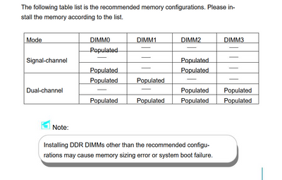

Reply 9 of 13, by H3nrik V!
Is that the correct memory slot occupation for dual channel operation?
Reply 10 of 13, by TrashPanda
H3nrik V! wrote on 2023-03-16, 06:57:
depends on the board honestly, but it looks correct.
Just looked up the manual.
79.99 KiB
1075 views
Memory config
Reply 11 of 13, by Sly_Botts
Yes, back then you didn't have to keep a slot between them. They were side by side. Unlike now where you have Chip, slot, Chip configuration. Also I would have figured it out by now anyway since the post displays if memory is running in single or dual channel mode.
