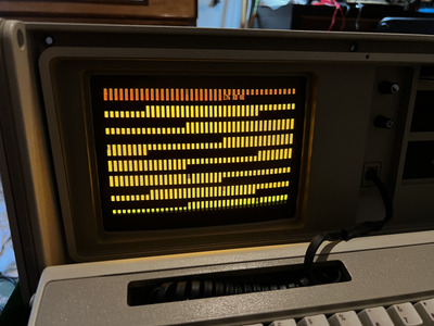

Hello! I have this IBM 5155 for a year now working perfectly and suddenly during power on I get one long beep and then two short ones, indicating a problem with the cga card, and then garbled text on the screen

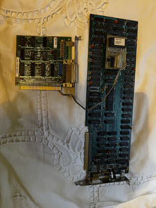

Note that the character rom is different than usual, having a memotek chip (probably with Greek characters since this was found in a Greek factory)

Any ideas how to proceed with this?😕
Reply 1 of 2, by Dimitris97
Ok false alarm i just cleaned the slots better and now its working again😁
