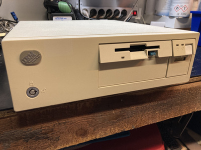

I got just the box couple of months ago. It was in very original condition that is, it had the 386SX-20 processor, 4MB RAM (upgraded from 2MB at some point), 40MB IDE HDD and that's about it. It has a Dallas CMOS thingy, but some previous owner had made the CR2032 mod already. Many of these systems had horribly unreliable Magnetek manufactured PSUs, which tended to release magic smoke after couple of years. This probably had one too, but PSU had been replaced probably sometime in late 90s, as the PSU had date codes from 1997 and it was made in Taiwan. It was pretty clean, just some mild dust inside the case and PSU had pretty much none.
Pretty clean system overall and no major scratches or bumps to be seen:

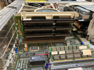

Looks clean inside too! Standard ISA, molex connectors on PSU and Dallas has CR2032 mod on it:

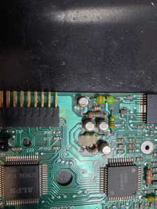

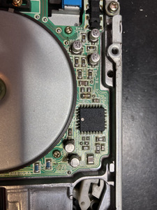

PS/2 floppy drives are known to fail. Usual suspects are dirt that gets inside because of open floppy slot and even more so, leaking SMD capacitors. My drive was pretty clean and it did rotate the floppy, but it just couldn’t read anything. My computer has a drive manufactured by Alps, and it has practically two circuit boards. The motor board, which has components visible from the underside of the drive and the controller board, which has components towards the top of the drive so they can't be accessed without removing the controller board. So, after removing couple of screws more and flat flex cables connecting the controller board, I had the drive disassembled in a way that I could change all the caps.
Gladly leaked electrolyte hasn't damaged anything, but pretty much all the caps had been leaking. It was evident when I cleaned the solder pads with wick as you can't help but notice that fishy electrolyte smell. Drive had all together 9 caps, five 10uf/16V, one 4.7uf/25V and three 4.7uf/16V of bipolar type. I had everything else except SMD bipolar caps so I replaced those with regular through hole stuff. There are plastic parts near some of the caps, so I was hesitant to use hot air while removing the caps so I went with a twisting method and I managed to rip one pad from one of the bipolar caps on the motor board. Fortunately it was still easy to trace and ripped pad was connected to the leg of one the SMD resistors near it, so I just soldered the leg of the through hole cap to the resistor.
Motor board before recapping, top three caps are bipolar:

Controller board before recapping:

So, I recapped and re-lubricated the drive and after that it worked 100%. Unfortunately I didn't took photos of the end result, but on the other hand, there is not much to see. Now that the floppy was functioning, it was time to start building the rest of the system.

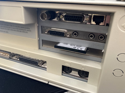

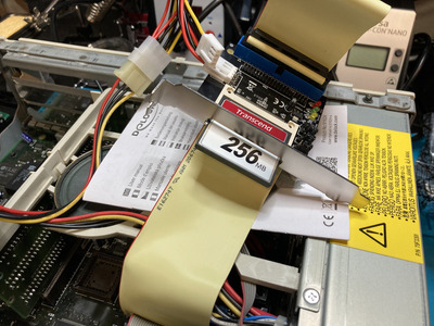

That 40MB HDD needed to go too. It was small back then and for today's tinkering it is even smaller. And it is loud. It doesn't make any abnormal sounds and I remember that those IBM drives were generally considered loud and slow already back in the day. I have few old HDDs, but I decided to go with CF route as I have both cards and adapters. Now, I had no clue what kind of HDD support IBM had implemented on these things. From the factory they were sold either with 40MB or 80MB HDDs. 35SX had also two BIOS releases and apparently later version had support for larger drives (mine is installed with later BIOS). But how large drive does it support? I guess I needed to test that myself. Smallest CF card I have is 256MB so I threw that in and hoped for the best.
Testing HDD support with 256MB CF:
851.47 KiB
753 views
It worked just fine! I installed DOS and even tested OS/2 1.4 on the 256MB card. So my system supports at least that, most likely a lot more and possibly the "usual" 500MB or so. While 256MB is more than enough for a system like this, it didn't quite end here.

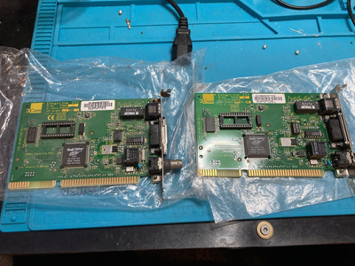

I have installed networking to every DOS system I have. It just makes life so much easier when moving data in and out of these old systems. I had two 3COM Etherlink IIIs laying around, so one of them was definitely going into the IBM. I have Etherlink IIIs running in a couple of my other systems besides an odd SMC card already and I find 3COM cards a pleasure to use: They just work and are easy to setup.
Two Etherlink IIIS, one of these went inside the IBM:

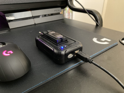

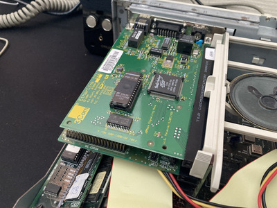

These old ISA cards have BOOTROM slot and it was time to move HDD size issues aside completely. I downloaded the XT-IDE binary and configured it in the IBM while 256MB was still acting as a HDD. After configuring the binary, I programmed an 8KB EEPROM I had in my components bin with it.
Programming the EEPROM:
712.06 KiB
753 views
EEPROM installed on NIC:
889.13 KiB
753 views

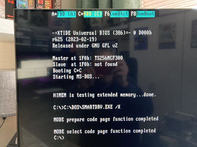

Testing if it boots with XT-IDE:
858.12 KiB
753 views
XT-IDE works beautifully! I removed the 256MB card and replaced it with 4GB one. With DOS 6.22 it certainly required two partitions, but I now have a ridicilous amount of HDD space available for a lowly 386SX. I left the 40MB drive inside the system, because frankly I don't have any use for it elsewhere and I don't plan on installing anything else in the bay. On with the next stuff!

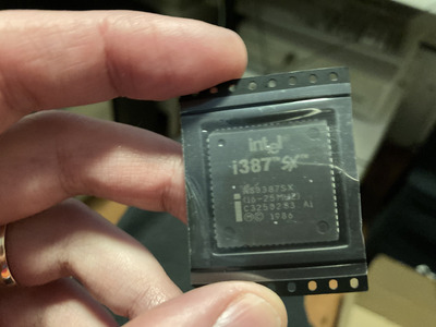

Now that the basics were up and running, there practically was only two things I could still do inside the case: installing a soundcard and a math co-processor. Now, I did consider installing an SVGA card as this has a plain old vanilla 256KB VGA and I have few cards laying around including a Mach64 ISA (which I even tested on the system). SVGA itself is relatively useless on this system, but I was at first little bit wary how slow the IBM on board VGA is. But I tested few benchmarks with the on board graphics and it is as fast as you can expect from an ISA system. For example, Landmark showed 3400+ characters while you usually cap at around 3500 with a stock ISA bus.

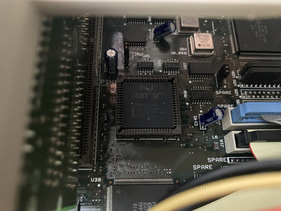

I managed to find i387SX for a relatively cheap price and so I got one:
i387 installed, this was the first math co-processor I have ever installed!:
691.73 KiB
751 views
755.01 KiB
751 views

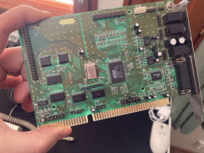

For sound I was first looking for something period correct, but I didn't have any such cards available and couldn't find anything for a reasonable price. So, I went with a trusty ES1688 card with jumper configurable settings:
961.37 KiB
751 views
ESS cards are fine sounding and IMO OPL emulation is really good, although they sound a bit different from the original. Above everything, they sound really clean. I wish Creative would've achieved the same with their CQM emulation. Now that I had pretty much everything installed, I could close the case and focus on finalizing the experience!

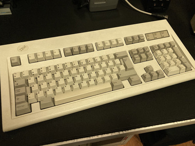

System was up and running and it was time to wrap up the project. But wait! I only have Compaq and some unbranded peripherals and while latter would perhaps be suitable for IBM, using Compaq keyboard and mouse with IBM would be a travesty. So, I guess I needed to get some IBM stuff to complete this thing.
White label Model M from 1991, needs a good clean but otherwise in pretty good condition. It already has a bolt mod for the back plate:

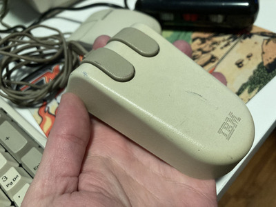

IBM PS/2 mouse. It's a bit crusty too, but nothing that a wash up wont fix:
697.53 KiB
709 views
So, I disassembled the mouse and keyboard for a good cleanup. Keyboard actually looked better outside than inside, there was quite a lot of nasty crap within the case, but otherwise it was in a good condition and membrane also looked like it would still last good few years without starting to crack. While I cleaned the key caps, one of the clips of the spacebar stabilizing bar broke down as they had become extremely brittle. Replacement key is already on the way, as well as "End" key cap which now just has a blank replacement. Spacebar still works as it is, you just need to give the key a relatively determined and straight push or it may miss.

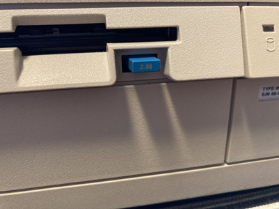

I found compatible ED-drive for 9€ and couldn't resist. A 2.88MB drive with same FRU as this was an option for the system, but I think very few customers actually chose it. There is not much use for it compared to 1.44MB drive, but as it was cheap, 35SX disk controller supports it and it is a nice curiosity, then why not?
Another nice surprise was that this particular Sony drive doesn't appear to have leaky SMD capacitors and after a good clean I tested it and it worked straight out of the box. It would be nice to test the full capacity, but unfortunately I don't have any ED-floppies at hand, which hardly is surprising.
I have now two working original drives, which is a nice thing as working floppy is pretty much a mandatory thing. Recently an adapter for media sensing drives became available, so regular floppy drive can be used in 35SX too, but at least I have a drives where eject buttons fit perfectly to the face plate.
