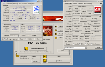

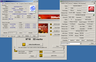

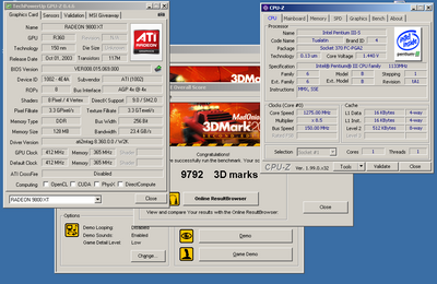

https://archive.techarp.com/showarticle57cd.h … artno=92&pgno=0
~5600 mark at 3Dmark03 with P3-S 1.133GHz, rig #1 at Windows 2000 😀
It has always been interesting what is more important than the frequency of the RAM or the processor.
The RAM frequency won.
150 RAM and 1.275GHz faster than
1.4GHz and 160FSB (120RAM)
Aopen MX3S, PIII-S Tualatin 1133, Radeon 9800Pro@XT BIOS, Audigy 4 SB0610
JetWay K8T8AS, Athlon DH-E6 3000+, Radeon HD2600Pro AGP, Audigy 2 Value SB0400
Gigabyte Ga-k8n51gmf, Turion64 ML-30@2.2GHz , Radeon X800GTO PL16, Diamond monster sound MX300
