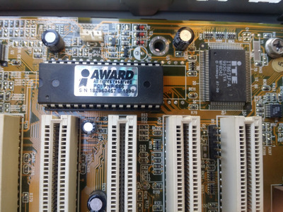

I got an old PC with SY-6BA+ III board, most of its components were working fine, however, the 20GB hard drive is totally ruined, so I had to get another 40GB drive and it turns out that the PC only recognizes drives up to 30GB, so I tried to update the BIOS and this is where everything went wrong and the motherboard is now bricked.
Apparently the BIOS that I tried to update was not correct because its size is 256K and the backup of the original BIOS is only 128K.
I think I can still recover the motherboard using a universal USB programmer, but I need your help to get a proper updated BIOS if possible to recognize my 40GB drive.
I know that I can recover the motherboard using a TL866 or TL866II, however these 2 universal programmers are quite expensive considering that I will probably only use them once. If you know of any cheaper tools that can help me, I would appreciate your help.
I am attaching a picture of my board's EEPROM, the BIOS backup, and the BIOS I tried to update.

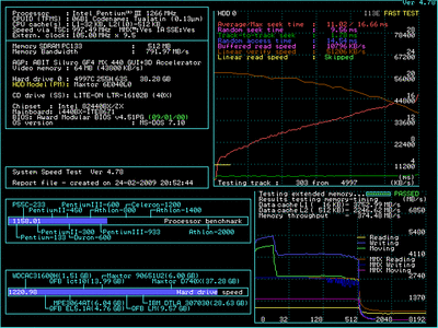

Attached an image proving the system was running with a 40GB harddisk. At that time the CPU was a 1266MHz Tualatin on a Slot-T adapter.

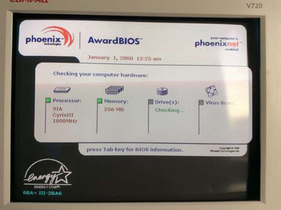

Also found a BIOS-post-screen photo, that I made, of it booting up with a VIA CPU.

It is very strange the fact that the backup is only 128k and that the boot screen before the motherboard got bricked did not look like in your screenshot.
In the BIOS change-log that I attached earlier, it says "Support Phoenix Net." in the version 6ba32ba3.bin of 05/09/2000. So I figure older BIOS versions looked different. That is also how I remember it.
Edit: I looked up "Phoenix.net BIOS". Seems to be some kind of early and discontinued spyware/adware integration project. So in that regard the newer BIOS versions are a downgrade.
