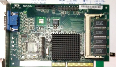

Hello!
I have this card and while it is detected, software reports its satus as "DISABLED".
Corrects model, core but no Vram size/freq. (of course!).
I visually checked if there were more missing components, failed or otherwise fishy but nothing.
No shorts.
I tried many things and I had to replace a SMD cap (100µF -10V), but that didn't change anything. I desoldered the one next to it to have an idea of the µF I should look for but it had a strange 80µF value.
Is it that sensitive to RAM to have, maybe, lower than 100µF on all?
This is the model:
http://www.vgamuseum.info/index.php/charts/po … millennium-g200
Pic is Millennium G200 core with "0316169ct3d 80 01l2303 IBM 5232 838702480 PQ" ram chips.
V on Ram has two values, many pins 3.33, another (only one pin) 5V (IIRC).
Anyone knows what these are? I can try to desolder them. Also expansion slot is ordinary sodimm?
Basically if anyone has any idea for what I should be looking for to find the fault, drop in!
Thanks foe the usual patience!!

Reply 3 of 11, by weedeewee
This sounds like a matrox pins issue ? ie corrupted/lost data in an eeprom.
solution is reprogramming.
Likely nothing to do with the actual hardware.

Reply 4 of 11, by Nexxen
weedeewee wrote on 2023-06-24, 04:11:
This sounds like a matrox pins issue ? ie corrupted/lost data in an eeprom. solution is reprogramming. Likely nothing to do with […]
https://web.archive.org/web/20040110103309/ht … .pl/gbm/matrox/
Re: In need of PINS for Matrox G200 SD PCI 8mb
Had NO idea it existed. Good to learn.
I can't locate the BIOS on the board, not the usual bold PLCC you desolder.
Thanks mate!

Reply 5 of 11, by Horun
Yes think that it it. A 32k serial eeprom chip iirc (diff than typical parallel rom dip chips used on many vga cards)
Reply 6 of 11, by Nexxen
Horun wrote on 2023-06-24, 13:40:
I'll probably sound silly but, can't I just deoslder and reprogram that chip?
Dind't delve yet into the Biosprog utility, and I'll eventually do a DOS run because it's more "retro". 😀

Reply 7 of 11, by Nexxen
Success!!
Working perfectly + tested briefly in W98 and drivers load just fine.
Took note of this G100/200/400 problem.
I actually wrote down to check BIOS always 😀
Downloaded BIOS from vgamuseum + BIOSPROG (just does everything no hassles).

The flash .exe found ver 1.3 and issued a warning.
After running it found:
- BIOS file version is the same as the currentversion. Do you still want to update?
- checksum invalid
- PINS chesksum OK
- Success - changed 192 bytes
It was indeed in need of a reflash.
The program does everything by itself, save old, check old, new, flash, report... you just need to run it. The programmer knew he had to make it easy 🤣
