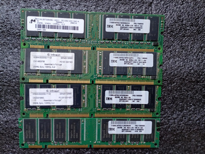

I have 4 sticks 256MB dual rank of IBM branded RAM and and CUBX-L motherboard.
BUT,
1 - Micron, 2 - Infineon, 1 - Hunix.
And they all have quite different SPD.
SPDtool reports an incompatible SMbus driver.
Frankly, I don’t want to solder, because the stick do not have a standard SOIC-8 case, but a miniSOIC.
In general, I need a program for DOS or Windows that works with 440BX for write SPD to RAM.
Definitely, I want 1GB of RAM on 440BX with a bus speed of 133MHz. 😀

Astra32 mail:
From: RusH
Date: Tue, 3 Apr 2007 11:21:25 +0200
Subject: Re: ASTRA32 uninstall
To: Support <support@sysinfolab.com>
On 4/3/07, Support <support@sysinfolab.com> wrote:
> Hello,
> Sunday, April 1, 2007, 8:09:43 AM, you wrote:
> cgc> SMBus probing is too aggresive, it breaks Asus boards (A7V133
> cgc> for example) = computer cant succesfully reboot, it hangs.
> Thank you for the bug report.
> Please send astra32.log file from 'My Documents' folder.
I dont have one, I allready uninstalled, but I can tell you what was
wrong (and can test fixed binary if you like)
> cgc> On the other hand you use some hack to enable SPD readout on
> cgc> this board, I would love to know what it is to backport it to lm-sensors.
> You can see this method in the BIOS.
Yes, I digged to it in the mean time (gpios are defined in the ACPI DSDT).
Back to problem with astra. To enable SPD readout you flip bit 0 in
0xe44d to 1 - that switches asus smbus mux to spd channel, but you
forget to switch it back to 0 and the board cant reboot properly ( I
know this because when I scan smbus before running astra I see only
hwmonitor, after running it I see only spd roms). No idea why the
board doesnt like it, maybe bios has to talk with sensor/clock chip
(both of them have watchdogs) and expects it on the smbus without
making sure mux is set properly.
https://github.com/raszpl/FIC-486-GAC-2-Cache-Module for AT&T Globalyst
https://github.com/raszpl/386RC-16 memory board
https://github.com/raszpl/Zenith_ZBIOS MFM-300 Monitor
Reply 4 of 4, by shevalier
Thanks for the solution.
Micron flashed perfectly, Hunix - it turns out that already in those years the first 128 bytes were locked for writing.
But, no luck.
124MHz FSB - ok, 133 - or RAM error, or no detect 1 stick.
Moreover, at any voltage - 3.4 / 3.5 / 3.65 Volts.
Need to look for and select other RAM sticks.
