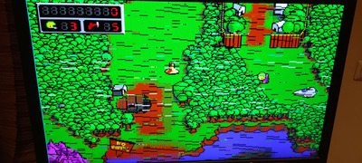

I have been testing a 386 motherboard that I got recently and I have a bit of a strange issue with it.
It has ami bios and it has refresh normal/hidden option in bios which I assume is for ram refresh. System runs slower if I set it to normal and more like normal 386 33Mhz speeds when I set the option to "hidden".
Basically the issue is that if I set it to "hidden" it will cause any tseng labs isa card I have to have corruption on screen in graphics modes but text mode in dos is fine.
1.09 MiB
928 views
I have tested 3 different et4000ax cards and one 1 et3000ax card from Tseng labs. With trident or ATI ISA video card everything is works fine, but I would prefer using faster tseng labs card. I have also tested switching different memory modules on the motherboard and I have also tested external motherboard cache disabled in bios. Basically everything is fine if I either set the refresh setting to "normal" in bios which makes the system run slower in benchmarks or if I use some other brand isa video card than tseng labs which are slower. Anyone has any idea what could be causing this strange issue and if there is anything I can do to make them work together?

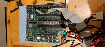

Here is a picture of the motherboard.

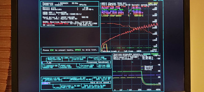

Vesa modes in pcpbench dont have any corruption and corruption in speedsys looks like this:

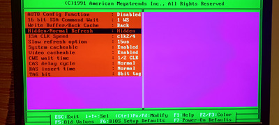

Can you post a screenshot of that particular CMOS setup screen you referred to?
Could be bad menory or also a flaky BIOS ROM chip.

Here is the image of the bios screen and that refresh setting:
1.02 MiB
902 views
It is the bottom one in the pictures on this page https://theretroweb.com/motherboards/s/jamico … 0a-486dlc-386dx except mine has socket instead of integrated cpu and mine has crystal for 33Mhz cpu. Jumper manual on the site does not match my motherboard.

Could be an incompatibility with the Tseng chipset. Try enabling auto config (first option) and see what happens.
Auto config option did not change anything and performance is exactly the sameit turned on. Still the only option that seem to affect is the refresh hidden/normal option that I mentioned.
That is a known issue with ET4000AX cards, you simply cannot use hidden refresh with them end of story

Honestly I don't know, a local bus 4000AX is a mystery to me, but I would assume they would not be affected since hidden refresh specifically decouples ISA attached DRAM from system DRAM refresh
