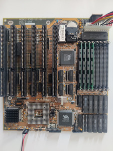

I'm in need of help... I accidentally removed an ISA video card from the motherboard while it was powered on my test bench. Nothing was damaged, I have visually inspected all components, nothing is broken or burned.
The motherboard doesn't want to post at all anymore. I'm using a Post test card, and I get no life signs at all. I've inspected all the voltages coming in, everything is there as it should be except it's missing negative 5V (white wire on P9 connector).
There is a 1amp fuse by the AT connector, which shows continuity as well.
I don't have an oscilloscope to test the ISA freq generator (14mhz), what would be the chance that it was damaged? I have a spare non-working 386 motherboard which I can use as a donor board.

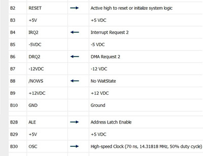

Ouch ! A friend once pulled an ISA modem out when computer was still on and it fried part of the south bridge/peripheral interface as it is near impossible to pull a ISA card perfectly vertical out of slot without some tilt.
If you look at ISA slot connections you can see that on the B side it is easy to get any of the AT supply volts being pumped to very important signal lines which can easily fry them.
The ones commonly fried are lines to Reset, IRQ2, DRQ2, or the ALE or OSC lines.

CPU is surface mounted, I think I can replace it if required. if 14mhz Freq generator is damaged, would that cause motherboard to not to post anything at all?
Reply 11 of 17, by majestyk
What does the "CLK" LED on your POST-card say?
I wouldn´t worry about the CPU. The ISA bus is hooked to the peripheral controller "VT82C481" (Venus Chipset).
If there´s any damage that was caused by mishandling an ISA card it´s probably inside this chip.
To verfy this you should probe all the IRQ, DRQ, DACK, data and address lines with a multimeter. Measure the resistance between each line and ground with the red probe grounded and watch out for any aberrations / non-typical values.
