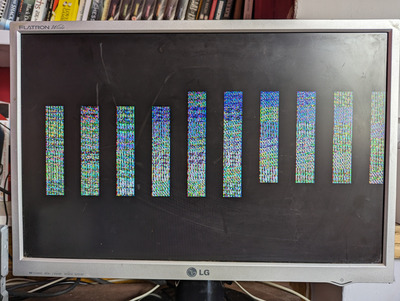

I have a STB Blackmagic 3D card I bought off eBay.
Some of the pins on the TMUs were bent and touching and there were a couple of capacitors missing too which I've replaced (see Voodoo 2 - STB BlackMagic 3D (PICS ADDED)) However the problem persists.
I've run MOJO after a clean boot and the card seems to be working perfectly. I then run QL Quake and there's a few blocks of noise on the display. I ctrl+alt+del out of it and then run MOJO again but it fails.

As you can see there quite a few errors there.

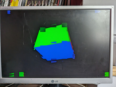

I've tried Googling them but haven't had much success. It also might be worth mentioning that DirectX Diag shows a spinning cube but has artifacts on the screen as shown below.
The attachment PXL_20230704_093237226.MP.jpg is no longer available
This is the GL Quake screen:

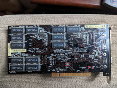

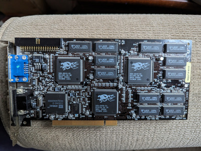

and the front and back of the card:

It's also worth noting that I've checked the traces and legs on the TMUs and DAC as well as the RAM chips. Is it worth reflowing them anyway just to make sure?

cookertron wrote on 2023-07-04, 10:05:
You are also missing C60 and possibly C61 on the front side, near the "PRODUCT OF MEXICO" sticker. Looks like whatever ripped off C60 took one pad with it, but the via seems to be there so some wire repair shouldn't be too difficult.
With all those parts missing I'd suggest going over the entire PCB looking for missing parts, cracked solder and bent pins first, before reflowing. Also, unless the stickers are paper and you really care about them, washing and drying the card.

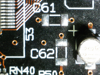

Reply 5 of 6, by cookertron
Deunan wrote on 2023-07-04, 13:19:
C60 was an electrolytic cap judging by the outline. Probably something like C59? I can't see the markings but I would guess 10uF / 16V.
EDIT: And now that I looked at it again, C50 near the end of edge connector also looks bent or half-ripped off. C49 and C51 below are suspicious too, but it could be just a light reflection. As I've said, go over the entire PCB with a magnifying glass and look at everything. Especially things that stick out and could be ripped off, and the dense chip pins in case some are bent.
I've put the card back under the microscope and checked the areas you pointed out. It looks to me as though 61 and 62 are meant to be voided whereas 60 has definitely seen better days. Hopefully I'll be able to use that via to make contact with the replacement cap.

Reply 6 of 6, by Deunan
Some of these not populated caps are probably power filtering (the usual ceramic 100nF or so) but omitted due to cost-cutting. So make sure any electrolytic caps you replace are low ESR or even polymer type.
