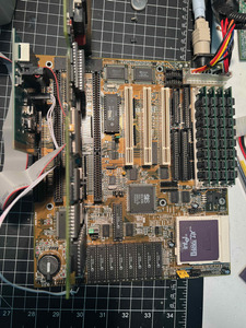

Greetings - I have 2 of these identical boards that came with NO BIOS Chips.

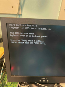

Using a WinBond W29EE011-15 I was able to program each of these BIOS files with my TL866 and the only ones that have some type of result are the AWARD files. (See pic from output). https://theretroweb.com/motherboards/s/msi-ms … 4-si1#downloads
I have reviewed this thread but without improvement. MSI MS-4144 ver 2.1 manual and BIOS help
Any ideas on where to start troubleshooting?

Reply 2 of 12, by TheMobRules
The AMI BIOSes probably have the same problem, it's just that those usually don't even display anything if the BIOS checksum is wrong. So yeah, either the dumps are not correct or there was a problem with the flash.
EDIT: MODBIN doesn't complain when trying to open the AWARD files, so I'd say they're probably OK. So it looks like either a problem during the flashing process or something is not right with the chip.

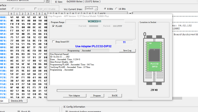

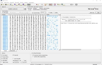

Updated my TL866 software and firmware. Tried 2 different Winbond EEPROMs. Both show no errors. Does it look like my settings are correct? Getting Code 13 10 on the post analyzer with no video.

Reply 4 of 12, by TheMobRules
Not that it would make any difference, but I've noticed you selected W29EE011 @PLCC32. From the first picture I can tell you are using a regular DIP chip, so you should choose the plain W29EE011. Again, both should work but just to discard any quirks of the TL866 software I suggest choosing the appropriate option for your chip.

Tried switching to plain W29EE011 - no luck. The 13 10 is when using AMI. When using Award it gives the same screenshot I put up that shows 'BIOS ROM checksum error', then 1 short 1 long beep. Code: 41 0d

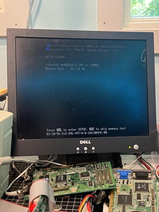

Reply 10 of 12, by Mohonkjoey
YES!! Thanks to everyone! It was the FP RAM vs EDO.
By the way, either BIOS works, both Award and AMI!!
