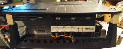

I have wanted to try some "don't give a hoot" builds that don't take themselves too seriously. I get locked up in analysis paralysis "what goes best with what" optimised build planning, so thought I'd start the other end, what's the crappiest parts I've got that will hang together in a system?
A story to lend flavour, putative scenario, it could have happened like this...
It's Christmas 2000, you are in your mid teens, you wake up excited to see what presents you got. You were real careful with your list, top of it, you put a 250cc Yamaha dirtbike and all the kit, heh, a ringer, you knew your Mom would NEVER go for that, and $3000+ was a bit steep, second, the real ask, and you put a lot of thought into this, a notch or so down from complete bleeding edge, so you'd get most power for the price, and they could shop for a deal, a new computer, PIII 800 with Voodoo graphics! And then some fillers maybe the aunts or grandma would get you, new skateboard, cd walkman, few albums you wanted... ... later you're sitting stunned... giftwrap all around, fake smile on your face with the new $50 WalMart skateboard, while Mom says Dad got wiped out in DotComs... no computer... Aunt Suzy got you the Venturer CD player, eh, it'll work.... ... ... ... 2001 You hustle, start out shoveling a bit of snow... mow a few lawns in the summer... at least you can listen to CDs your buddy copied for you... earn a few bucks... but your buddies want you to go to the movies... there's a pair of jeans you want... man this bread comes hard... never gonna get a PC... unless... how hard can it be to throw one together?? ... few cheap new parts... beg the rest... fill the gaps with used...
Motherboard: MSI MS-6340 K7TM Pro, KM133 SDRAM .... lowest end socket A board I've got
CPU: Duron 900 Spitfire core
Graphics: Radeon SDR/7000 VE AGP
RAM: 2x128MB SDRAM DIMM, not quite so low low end, 7ns chips
PSU: 200W should be enough for this, so I'm using 475W... that I just about trust to do 200W, yeah a "don't leave it out in a stiff breeze or it will blow away" unit.
HDD: 20GB fireball that betrays it's name.
OS: 98SE
Case: Yeah about that, that's where it gets weird...
I have a monitor stand, I do not require it to stand a monitor upon, it is in fact a bit of an awkward size, not quite the size for sliding modern laptops under for modern docking purposes, a bit of a spacehog compared to the foot of most LCDs I've got, and a bit lost if used under big CRTs, so I decided it needed a new purpose in life. The top surface is actually another panel that is screwed on, and thus I removed it to maybe form a lid. The stand is to be used upside down and the legs extended to rest lid upon. Card holder is some pieces of cheap meccano/erector set knockoff screwed to the game port. PSU will go behind motherboard, just. The build might end up resembling a glorified test rig, or might gain some side panels and look presentable, not sure yet, just gonna roll with it...
Some difficulties were encountered in determining if the board was fit to use...
    340.41 KiB
    1784 views
    A dead monitor stand with an MS-6340

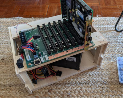

I also love a test bench made from repurposed items:
129.77 KiB
1763 views
So what is next for your masterpiece? We must see it in action.

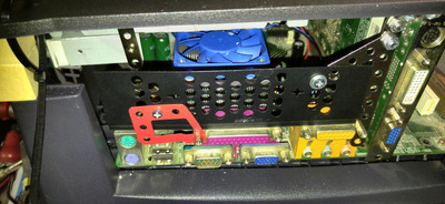

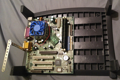

Reply 2 of 20, by BitWrangler
Yes I could use a dedicated test rig/stand, I have in mind a particular kind of citrus fruit crate I have seen around, but whenever I come across one lately, it's bent broken or slimed.
So, I've got the board screwed down, 3 self tapping screws through base, the PSU screwed in, 2 screws on the back edge via "meccano" pieces. Got all the leg extensions installed, these are 2cm cube "beads" from the craft section of dollar store, seem to be made of hard beech. Two of those are stacked and a deck screw run through them, countersunk. They are offset because of the taper of the legs, so that sides if later attached will be vertical, and also they come to the corners of the lid without overhang. Got the card frame steadied, seems pretty solid when a card installed. Note the last PCI slot is obscured, but I still have 2 to use, and the 3rd one can still be used for internal cards, like a goldfinch, RAID card or PowerVR.

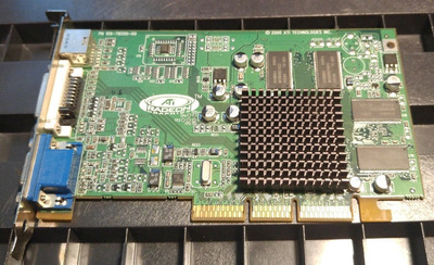

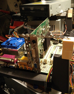

Pic of the Radeon that's going in. May mix it up with the GPUs later, maybe try a TnT2 and a SiS Xabre 200.
Need to figure out the optical drive, button/LED panel and card reader mounting. Figure they're going to dangle off the lid, but I don't really want screw heads on the top surface. Thinking maybe I could try pop rivets because they are lower profile, or I might epoxy in the brackets, but plastic and metal have a habit of flexing apart with wear.
Edit: Oh I meant to say something about the PSU, it's an "Orion" the only reason I'm using it at all is because it's got a CSA number and when I checked last year or so, they were still selling them, since a decade back or so. Thus not having been sued off the market, I figured it wasn't actually gonna burn my house down, but I'm still gonna keep it switched off when I'm asleep or out etc.
EditII: Looked it up again, found BadCaps teardown which makes me feel mildly better about it, not quite bottom of the barrel, they reckon it's good for 350W.. https://www.badcaps.net/forum/showthread.php?t=8011
    260.17 KiB
    1720 views
    Radeon SDR or 7000VE IDK there's even sellers calling them DDRs this model.
Reply 3 of 20, by mkarcher
BitWrangler wrote on 2023-08-10, 02:36:
That card is a Radeon VE aka Radeon 7000. This card is not to be confused with the "Radeon SDR" that got later renamed (along with the Radon DDR) to Radeon 7200. The Radeon VE indeed uses DDR RAM, so the sellers listing that card as "DDR" are not wrong. In contrast to all other Radeon cards (including the Radeon 7200), the Radeon VE / Radeon 7000 doesn't include Hardware Transform & Lighting. While the Radeon 7200 used 128 bit memory access, the Radeon 7000 only uses 64 bit memory access, so the data rate of the Radeon 7000 with DDR RAM is very similar to the Radeon 7200 with SDR RAM.
Reply 4 of 20, by Standard Def Steve
I have the PowerColor version of that card, which IIRC looks identical. It's a slow, slow card that even manages to bottleneck the life out of a P2-450. At first, I placed most of the blame on the single pixel pipeline. Later on, when I had the card in an XP machine, I discovered through GPU-Z that it only has a 32-bit memory bus. 32-bit!
However, I don't believe all 7000/VEs use a 32-bit memory interface. This PowerColor is some late model, ultra-trash version that I picked up at Staples for 29.99 CAD in 2005 because I needed a third DVI output.

Reply 6 of 20, by mkarcher
Standard Def Steve wrote on 2023-08-10, 15:35:
The memory chips on the Radeon 7000VE chips have 16 bits per chip. Usually, these cards have 4 chips, 16 Megabytes each for 64MB total. In fact, there are some cards having only two of these chips, a total memory 32MB and 32 bit memory bandwidth. They might be usable as DVI-capable office cards, but obviously they are not recommendable for 3D at all. When you want to go low-end Radeon for a non-3D-gaming build with DVI output, I would still suggest a Radeon 9000/9200/9250 over a 7000. On the other hand, if you care about analog VGA signal quality, stay clear of anything labeled Radeon 9200 or 9250.

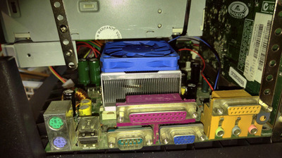

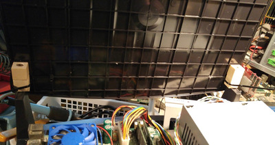

Reply 8 of 20, by BitWrangler
Yesterday kinda stalled out with interruptions, and that I went off on a false trail thinking about hinges for the top. I wanted the top to "stay in position" somehow, because otherwise hooking up the drive cables etc was going to be a bummer. Also altering anything inside with drives on the lid would be annoying. So I went off on some hinge hunts, drew blank, thought about various complex arrangements and... decided screw it, this is suppose to be crude and simple, using cable tie loops to hook on the uprights to keep the lid in position, first pic hopefully.
Then got into mounting drives on the lid, was going to do more brackets, but I got rather annoyed fighting with the rivet gun, it's like a fastener system that works all the time some of the time, spent more time digging the failed rivets out than anything else. It might be that I've got crappy rivets, they were breaking the stem bit at odd points, like a little up from where the notch was in it, where it's meant to break. They didn't seem to be clinching fully either. Some of it might be that the joint was an in between thickness, I had 1/4" inch long rivets and half inch long rivets, the quarter inch were clinching below the bracket and pushing it away, the 1/2" weren't fully clinching on it. So I guess I needed 3/8. Having only got two on there firmly, I was all "screw that, zipties for the rest".
Last pic is side view, not a lot of clearance. Looks a bit worse than it is on this pic, the drive is covering about a third of the HSF and since fans tend to draw most from the hub area and throw it out, this is probably not restricting as much as it seems. The graphics card isn't all that close either I can get two fingers between them... IDK if I'm gonna get some "snow" from the IDE cable being close though.
You might notice that the "back" of the board is at right side, and "back" of PSU is at the left, with nothing at the actual back, this is sort of a design decision of thinking "What if I could push it all the way back to a wall" rather than having to leave cable clearance.
edit: BTW never saw what case or system that button/light panel came from, arrived here stuffed in a bag with a other random case wiring in a box lot of used heatsinks I got ages back.
    259.92 KiB
    1485 views
    The un-hinge, just kinda looped on.
    225.62 KiB
    1485 views
    Drives in there somehow.
    504.63 KiB
    1485 views
    Side view. There's room I swear.

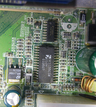

Stupid thing has gone back to that "picking lottery numbers" fail mode, C1 C3 25 2B 1D etc no particular order.. half of them don't even make sense.. purpose "reserved" for 4.51pg but in other versions they're things like "checking 5th slot" it doesn't have a 5th slot. Took out the CPU and nuked it with the high power contact cleaner... no improvement... maybe I'll try the RAM slots but I had the impression it was more to do with the CPU socket last time... either I'm gonna need to detail clean about 800 contacts individually with a toothpick or it needs a reflow or something.
Reply 16 of 20, by BitWrangler
It's a precision instrument the same as a hammer is, but seem to have narrowed down problem area on board with freezer spray. Premium contact cleaner on RAM slots did "nothing" (They might be cleaner but didn't make it POST). Anyway, any time this area is hit with the freezer spray, I can get it to POST to system summary, and by that time the frost is gone and it blackscreens. I do not think it's the electrolytics as hitting them specifically does nothing, it seems to be some bad connection or one of the SMDs acting up. Gotta find a hard point in something non-conductive to press things with, pressing larger elements, packages, with a pen didn't seem to do anything, while powering on.
It's like where's Waldo, for geeks....

Reply 17 of 20, by BitWrangler
Holy crap, prodding and prodding and prodding and prodding... but none of the SMDs.... got it I hope though, that big green cap to the right, happened to wobble it and felt the very faint tick, yup, moves just like it shouldn't, it's loose in a hole... had to get board out, flipped it up, could only very barely see the crack line but the solder was just lifting off the via, damn. Didn't think I could get a pic of it though it was that hard to see. Touched it with the iron, now gonna try putting power to it again, cross your fingers...
edit: Impossible! How could that not be the big IT it ??? Getting the same errors again and wedging on C1 if I do them back to back without a minute or so in between. That voltage IC is getting ouchy hot, maybe it's RAM voltage that's going funky. How could it have glitched somehow working enough to boot windows safe mode a few times, Install windows98SE and play a round of hearts, then glitch out again following day, and be not glitching back in... though I did think I should have pulled that cap all the way off in case it lifted a trace on top and broke it.. but still, back to shooting cold make work for short while. Guess I gotta actually measure some stuff, my probes are too fat, better find some pins and clips.
EditII: Wednesday update, ignoring the hell out of it before I throw it through a window 🤣
