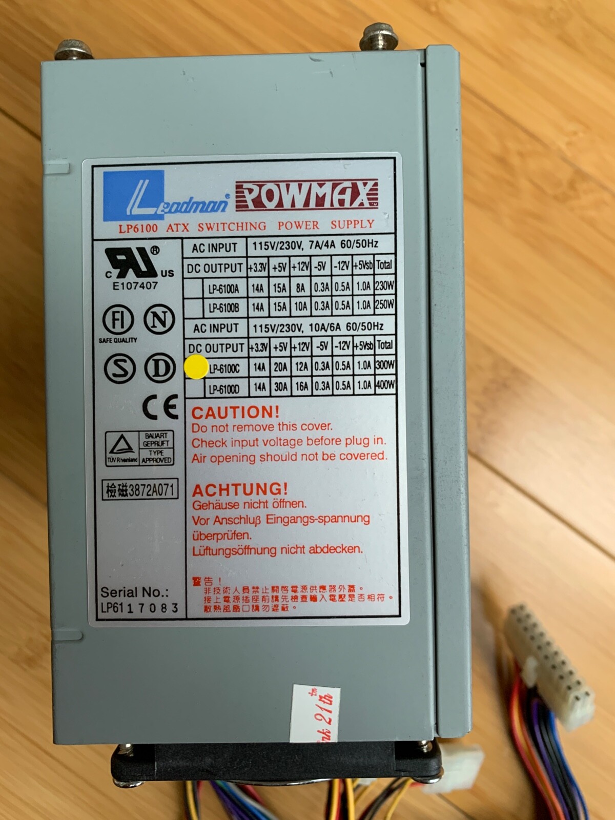

Perhaps a bigger issue is that the matx power supply that works with the matx board does not give any response when plugged into the 486 board through the p8/p9 conversion adapter. According to the internet, it’s the same as any other ATX psu, just lower wattage, so I’m puzzled why it doesn’t power on.

486 board might need legacy -5v, which modern atx psu does not supply.
See also 'voltage blaster' and pals.
Additionally, a hard toggle switch is required for the poweron signal, to keep the atx psu active.
Actually the "probably fake" micro ATX PSU Powmax is labeled 300watt where the older better quality SPI that does work is 250watt.
The original Leadman Powmax PSU have a label like this: https://i.ebayimg.com/images/g/2NIAAOSwIFVjzqTO/s-l1600.jpg
Nothing like your matx psu. What you bought is not a true Leadman Powmax IMHO and I would not trust it....just my opinion.
