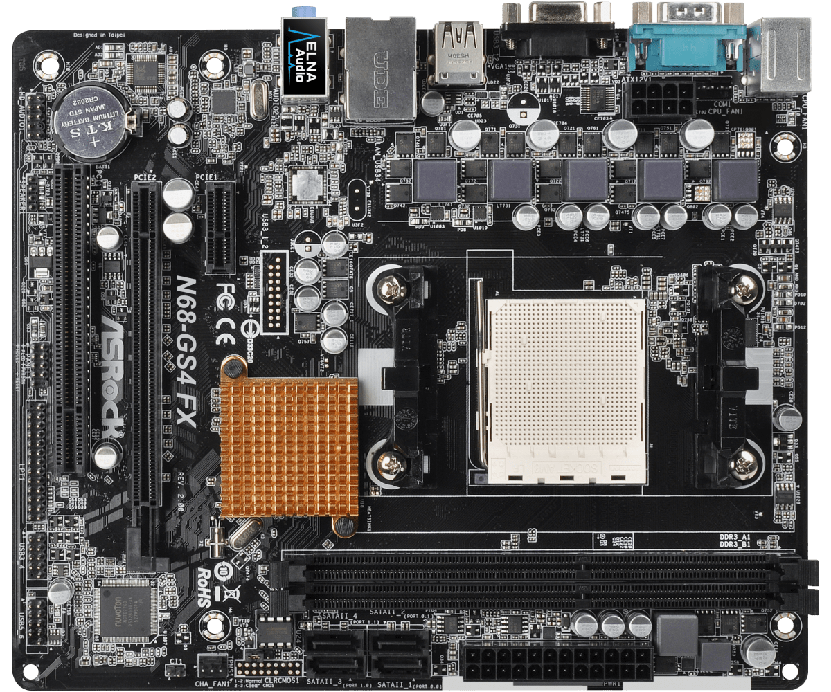

The n68-S3 is not really an 'old' mobo, being released in 2010 ~ this board did 24/7/365 service as video surveillance recorder ; it was retired in 2017 after a couple of spurious lockups ~ I could see the issue back then, and thought "that is a great example of how much heat plays a part", bagged it up for future repair 'one day' ....only took me 6years to get around to it... =)
This is my fault for not noticing how truly underwhelming the original design is, with the CPU socket orientated such that hot air being blown out of the CPU heatsink, goes straight onto those 2 bulged capacitors, and the NF-7025-630A-A1 chipset heatsink....and the 1st DIMM on the other side ~ I really should've picked that up, and fitted a liquid cooling solution instead, my bad =( ..or else Asrock gets the blame...
The real bad cap top-right, I believe is on the phase directly feeding the MMU ... only DIMM slot 1 closest to CPU tested clean, with the other DIMM slot throwing inconsistent, never twice the same result errors. Replacing just that cap cured this issue ~ obviously I'm going to replace other caps but one can learn a bit about how the board is wired, by validating the cause/effect relationships ... rather than just replace all caps at the sight of a single bad one =)

Or N68-GS4 FX R2.0(L2) if you prefer ASrok.
