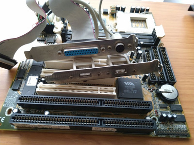

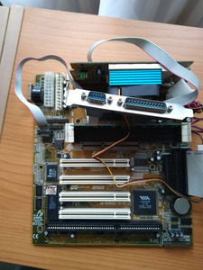

hi , i have old Zida BX98-3D motherboard, but icant see any ps2 and usb ports on card. in manual there are slots but not on card?

PS2 and USB ports are on bracket, which connects to the 20pin connector between COM and PRINTER headers.
Reply 3 of 21, by Ydee
I mean original bracket, which seem to be as this from Asus (cannot found original Zida picture):

i see but com 1 and com2 ports not working im using serial mouse

Reply 5 of 21, by BitWrangler
Did the serial header come with the board or was it obtained elsewhere?
Asking because there are 2 common, one less common, and several rare and weird pinouts for serial headers.
Reply 6 of 21, by rain
Serial headers come with board
-386-4MB-
Reply 7 of 21, by Ydee

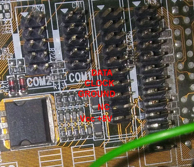

On the non-original, you have to measure where you have the individual wires for data, ground, Vcc and clock and sort the wires into a line accordingly to match the header connection - header wiring is in the manual, I marked it for you on the pics.

This original bracket is not for COM (serial) port header, but for custom 20pin combined header as you can see on the top image.

Im using this for serial mouse but did not work either

Reply 10 of 21, by Ydee
rain wrote on 2023-09-22, 15:56:
This may be due to a different wire connection, there are more ways, see: Re: I can't get my serial port mouse to work.

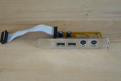

I found a photo of my old Zid BX98-CT. The original PS/2 bracket looked like this (but as I was saying, you can use any other with wires connected correctly) :

Reply 14 of 21, by rasz_pl
rain wrote on 2023-10-29, 15:16:
Thanks this mobo looks like mine but com ports (serial) not working did you try it on yours?
for the nth time- there are many ways to wire serial dongles, you need to take measurements on your board and make one yourself

I have a Zida board with similar headers and yeah, I had to rewire a one of my DB9 breakouts (Everex I think? actually looks like it was from Everex to DTK/Intel) to get a serial mouse working. USB works with my case's USB 2.0 front panel header. 😈

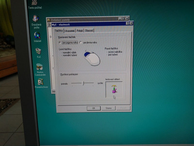

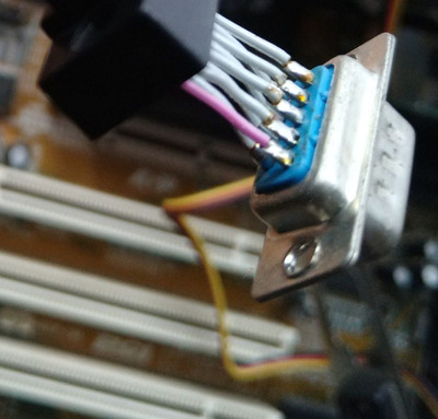

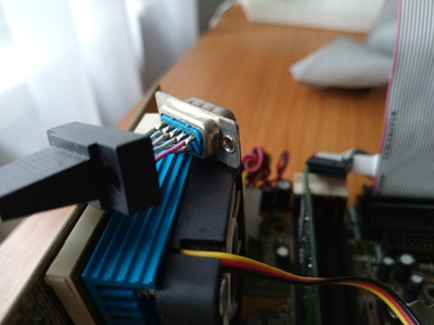

Unfortunately not on this one, I had to sell it for lack of space. But I have a similar one, only a slot 1, on which my regular Genius serial mouse works. COM header is plugged into this bracket and the pins are connected alternately to the top and bottom rows in brackets, look at the picture. The mouse works in MS-DOS, W95 and W98SE.
Reply 17 of 21, by Ydee
And slightly better angle:

so that i undersfand, all serial connectors not same?

Reply 19 of 21, by rain
Or maybe motherboard com ports broken
