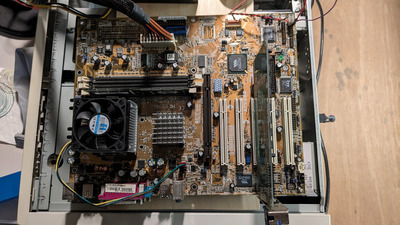

I got this motherboard from a friend and I have some left over components from upgrades I did many years ago that fit so I figured give it a try. This board has that really annoying voice that says "system failed memory test" and "system failed cpu test" and I must have heard them a thousand times by now 🤣. At first I didn't know what I was up against, but after reading the forums about this board, apparently the board is of dubious quality, and allegedly finicky about ram & cpu. I'm not an expert, but my experience with the board to date tends to confirm that. I replaced the 7 "large" capacitors around CPU thinking that might clear up the issue, but still no joy.
I can usually get past "system failed memory test" by setting jumpered mode, SYSCLK 133MHz (for some reason the memory bus doesn't like 100MHz) and occasionally I've gotten both the memory and cpu test failures to silence with a Duron D600AUT1B, but still no video coming up. I've also tried a A0750AMT3B and AX1800DMT3C with no luck (these two I can't get past the CPU errors.) I've tried manually incrementing the voltage, resetting the bios (well there's no battery in the board atm) and ROMSIP.

Probably just torturing myself with this project, anyone have a gut feel for how I might get this board to POST???

CPU's I've tried fitting to the board:
Jumpers Used:
  • JEN / SYSCLK (100MHz usually doesn't work for some reason, but 133 does)
  • VID Limit & Output - Tried all 4 settings for each CPU
  • ROMSIP
  • Reset Bios settings and i've been testing w/o a battery on the board
  • Probably others...
**Also replaced the 7 "large" capacitors around CPU
Let me know if you have any ideas, I'm at my wits end with this board! hahahah!

FWIW I've tossed 2 of these into ewaste this year, as unrecoverable... first one had some northbridge issue (heatsink getting way too hot waiting for POST), second one had a southbridge issue (would POST but fail to install any OS once it got hot...ATA channels would 'disappear' =). Both boards came from the warmer climes of AU and so I concluded that they both suffered from 'heat prostration' <grin> ...

Might have been able to salvage one working board from the pair, swapping the working southbridge chip for the one with the bad chip (or vise-versa with the northbridge).

Indeed, I've tossed so many different branded boards all with versions of the kt333 chipset... and to this day the vt8233 southbridge is the only one I've ever seen blow a hole in itself and let out the magic smoke... for 'no apparent or obvious reason'.

Getting the hint - this board / chipset is crapola! I did check the northbridge heatsink and it's not overheating.
A few questions if anyone has a clue:
- how much of the board has to work in order to deliver the voice errors "system failed cpu test", "system failed memory test" ... etc. Does this indicate the bios is functional? less?
- any idea why SYSCLOCK 100Mhz always creates "system failed memory test" but 133Mhz doesn't?
I can get past memory & cpu test with the Duron using higher voltages, but no video on an AGP or PCI video card and the Duron overheats almost immediately afterwards. I can tell because the cpu heatsink is super hot and "system failed cpu test" comes back when I try with a hot processor.

Well you are trying 133 with 100fsb CPUs it looks like, which if they were very unlucky samples would cause early overheat and no boot, so if those are all that is available, then focussing on getting 100 working would be more likely to work. Pursuing 133 operation on CPUs that aren't guaranteed to do it will have you chasing phantoms rather than the actual problems.

Spent some time on one of these just now as well. Some years back the board started having intermittent trouble booting and from what I remember sometimes wouldn't boot cold, just spun the fans the first couple attempts. Eventually stopped booting altogether. I replaced the 3300 uf caps and cleaned up corrosion around the line of SMDs next to the northbridge, no idea how that happened. Still the same CPU test fail message and blank screen so I tossed it.
The undocumented overvoltage jumper probably didn't help these things. I think at some point after taking the board out of storage with most of the jumpers removed I went over the manual to restore the jumper configuration but missed the overvolt one, so for some time the board was running unusually hot.

Thanks for chiming in. I'm going to keep this board for parts, but that's about it, I've moved on to a totally different Socket A board that I came across which confirmed the other spare parts I was using (CPU, Memory, etc.) are perfectly fine.

It's a decent board for benchmarking video cards, shame to scrap it. I took out all 1000+ uf caps to use in other things, tested a bunch with a multimeter and none measured bad. Don't have equipment to test them any further than that though.
