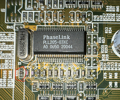

Got an not booting Abit KT7A board with missing IC.
Could one of you KT7/KT7A owners check what U14 (see picture) is for an IC, or send me a close up of it?

Memory says it's dual p/n-fet, for switching the RAM power supply from the main 3.3V to a 3.3V supplied by the +5VSB for when using sleep mode. I know that's not much help just now, but if no one has a chance to have a look then it should be possible to work out a component that'll work.
Is there a pad for pin 2 missing?

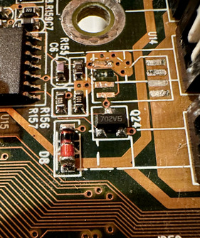

[oh, and if possible could you let me know the marking on Q24? It looks like I didn't put mine back when I was fiddling trying to track down a RAM fault]

IC is ordered and here is the picture of Q24. It's labeled with 702v5. Is it an N channel MosFET?
...and yes, the pad is missing. But I think I can fix that quite well.

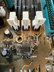

Reply 3 of 17, by shamino
This is from a KT7A-RAID v1.1:
53.66 KiB
1288 views
looks like it's probably the same part snufkin found on a KA7, but I don't know what all the markings mean. The top line matches at least.
I tried to take the picture through a sealed bag, so if you need a clearer picture, or something else from the board let me know. I'll be happy to open it if needed.

Thanks for checking that Abit hadn't changed that bit of their design going from the KA7 to the KT7. Thanks also to Theseim for checking on that Q24, it does look like it's an n-fet. I'll need to double check that it was originally fitted (very likely was), then refit one. Board works without it, although I guess sleep mode wouldn't. Maybe I ought to test that first.
Reply 6 of 17, by theseim
As you said snufkin, it was actually not the FET at the Ram slots, but a torn resistor next to the clock IC! But either way everything is done and the board is now running again!

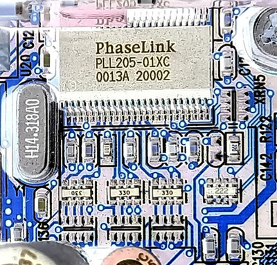

Reply 12 of 17, by theseim
So, I have now tested a little more extensively. And the reason seems to be completely different. It turns out that the system runs 100% stable and there are no keyboard or mouse dropouts as long as the fsb is running at 100 MHz. If I set the board to 133 MHz fsb, I get mouse and keyboard dropouts after 30 minutes at the latest. The active Northbridge cooler works perfectly and I have also applied fresh thermal paste to it, so I would rule out a heat problem here.
However, as described above, I resoldered a missing resistor. It was R49 near the clock generator IC. Did I perhaps solder the wrong value? As it appears to be a pull-up resistor, I have installed a 10K (ID 103). Is this a different one on your boards?

Reply 13 of 17, by snufkin
I've only got the KA7, so even though the RAM voltage supply was the same, I expect the clocking will be different. I'll try and have a look mid-week.
I still suspect something is over-heating, but that's just a guess. I don't know, but are the PS/2 ports driven from the Southbridge?
