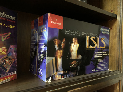

Reply 2 of 36, by DerBaum
If you need any drivers or pictures of the manual just let me know. I have 2 Boxed versions of this card.

I would love to have the drivers that came with your CDs if possible, does your manuals have anything related to the DOS apps?
