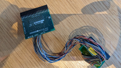

Hello,

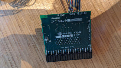

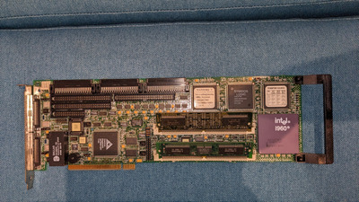

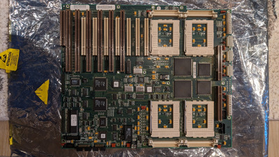

Could anyone help me out in identifying what sort of hardware is on these photos?
I'm guessing this was a server machine, and is missing the CPUs, would Socket 8 Pentium Pro 200MHz CPUs work with it?

Do you have the voltage regulator modules for each CPU? How do you connect a keyboard?
The power inputs look interesting. Do you have the Power supply?
Is the connector on the left edge of the board on the last picture broken? If yes have a look at that so no pins are shorting out.
I saw some UNISYS markings on the parts. Maybe thats a direction...
Based on the dates on the chips i would say its from around 1997.
Some of the chips that look like the bios have lables with "9941" on it ... thats probably the board type
I don't have a power supply for it, what kind of PSU would it require?

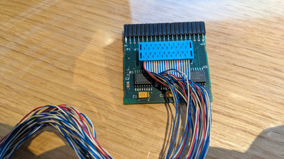

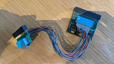

I also don't have VRM modules with it (as far as I can tell, but there is something resembling it, attached are pics of the part, not sure what is that though either).
I don't see anything broken on the board, there is a missing connector for JP4 on the left edge if that's what you pointed out, but I can see it was never soldered to the board, might be something optional / never added to this particular model?

I marked the port in question. It seems not straight and the plastic is broken in several places.
I thought i saw pins touching each other .

oh you are right, didn't notice that, that is broken indeed, damn!
Reply 7 of 30, by majestyk
Yes, the 4 white connectors are for the VRM modules.
You need "Pentium Pro VRMs" here, these are somewhat hard to find today. On Ebay there are lots of VRMs for sale, but most are for PIII or proprietary ones.

Based on the part nos. (38687620) it seems this might be the system board from a Unisys Aquanta QR/6 Server (DM/6 Client)...
https://www.1000bit.it/js/web/viewer.html?fil … f#zoom=page-fit
https://www.tpc.org/results/individual_result … isys.qr6.es.pdf
ECCS (Enterprise Computing & Computer Storage) had a deal with Unisys related to raid sub-systems, fault tolerant and network attached storage so I guess those modules are perhaps interfaces to cards you don't have.

That is the "little" brother to the ALR 6x6. Advanced Logic Research. I think they called it the ALR Revolution Quad.
https://linustechtips.com/topic/1088190-first … et-motherboard/
That slot on the very end is broken. it will need to be replaced. It is the slot for the PS/2 ports and other general I/O

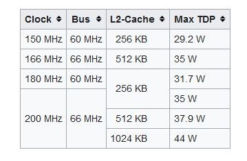

These VRMs are rated 35W, this might restrict the Pentium Pro models that can be used:

oh, hmm, I ordered 4 x 200MHz / 512kb Pentium Pro CPUs, do you think these absolutely cannot work with those VRMs? could it be the case that those VRMs are just declared for a lower power rating, but they in fact could support a bit higher draw (e.g. in this case this 3W difference)?
If it's really a no-go, do you have a recommendation for a VRM that would surely work?
Thanks!
Reply 18 of 30, by majestyk
In this case the maximum TDP is just 7% over the nominal rating, so the VRMs will cope with it.
A decent _active_ CPU cooling with the airstream heading toward the CPUs wouldn´t hurt.
