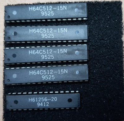

I run speedsys 4.78, and verified that it did not detect any second level cache.On the bios the external cache was enabled.
So i removed all 4 cache and TAG chips and tested on the TL866 and the Retro Chip Tester giving them as damaged.
file.php?mode=view&id=176826

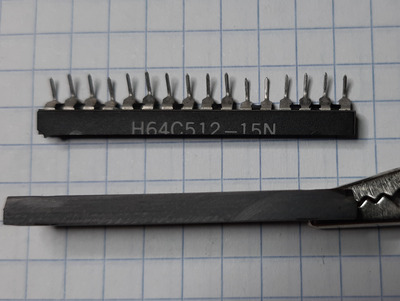

Cut one chip in half and...no silicon chip !...
file.php?mode=view&id=176825

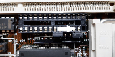

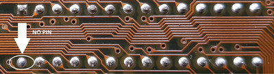

So like PCChips this motherboard had fake cache..., i thought only PCChips had fake cache on their motherboards...
But I also found another problem, see the photos of the TAG RAM socket, the VCC pin (+5V) is missing, so the (ghost) chip has never been powered...
file.php?mode=view&id=176824
file.php?mode=view&id=176823
Since the motherboard no longer had a true cache, they didn't even notice the problem.

Reply 1 of 1, by dominusprog
I believe some boards like A-Trend ATC-1020 have these dummy chips so when the COAST module is installed it replaces them with the real chips.
