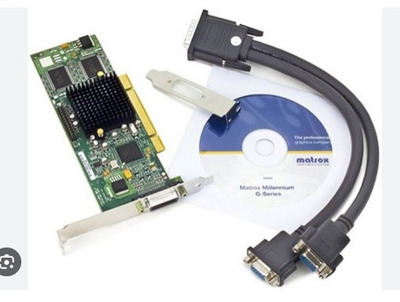

I have Matrox G550 in storage with its "authentic dual cable" and Matrox's own proprietary connector.
Never got it to work probably because its special dual cable or card itself is broken.

Reply 2 of 16, by Ryccardo
user33331 wrote on 2023-10-31, 10:52:
special dual cable
Unless they pulled some stupid trick (...like they did for VGA to composite/s-video cable that apparentlynnever worked on my G450, although to be fair they're not standard anyway), isn't that blurry thing just a DMS-59 socket?
...cables for which seem to exist in way too many varieties for it to be anything close to universal 😀 🙁
Reply 3 of 16, by dionb
The G550 PCI needed one of those cables, the AGP version just had DVI-I and VGA on the bracket so 'just worked'.
