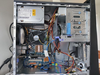

Not only fans are annoying on these, but generally the big boys like HP, Dell and Lenovo (and even MSI on their prebuilds) tend to make their own in-house standards for connectors; oh yeah, the USB connector might fit on some models (HP and MSI I know), but is not always industrial standard connected (OK, in this case the MSI Nightblade I have been working with did in fact have standard USB connector but it also required a specific PSU with a proprietary power connector to the board hosting USB, USB3, audio and switches, HP will often have an extra pin that needs to be grounded). Lenovo has a 12-pin block with 10 wires connected in their own way, the audio uses a 14-pin connector - with a lot of empties! and the front panel (switches and light) also uses a 14-pin connector. Luckily I have found a diagram of Lenovo's in-house connectors and managed to connect wires from the original plugs to the board so everything can be reversed. The front panel I already had made long time ago in my previous builds, but this time I also printed and taped the pinouts to the inside of the case.
If you want to see my big, ol' mess of wires, then here it is:
1.74 MiB
263 views
A Gigabyte in a Lenovo - a mess of wires!
The tiny, blue cables are my wiring - but then, note the blue SATA cable - an original Foxconn Lenovo 😉

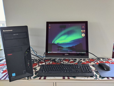

Once it was up and running (as the picture indicate with those nice, spinning fans, it was time to install the OS. At first I wanted to just install Windows XP, but since the Lenovo originally was installed with Windows Vista, I decided it was about time I did a Vista installment. The installation went pretty smoothly and after driver installment the 32-bit Windows Vista Business were ready for business - with a 5.2 on the Windows Experience Index I might add. As I recall Vista's maximum is 6.0 (or 5.9?) and with a better hard drive I could get it up at 5.4 since this is definitely not a gaming graphics card.
The setup continues with it's drag by adding the appropriate Lenovo MO28UOL mouse and Lenovo KU-1619 keyboard - and if only I had a Lenovo screen I would be truly happy! (however my wife wouldn't)
Now I just need to find out what to use a fake Lenovo Vista build for... Any ideas?
