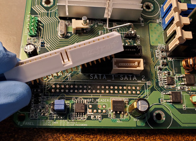

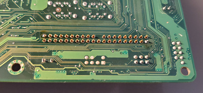

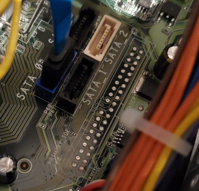

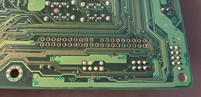

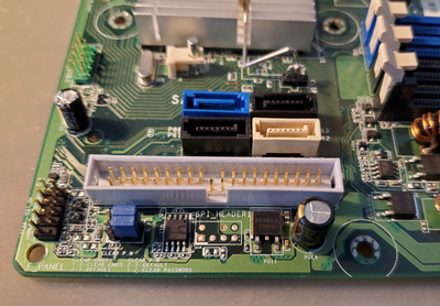

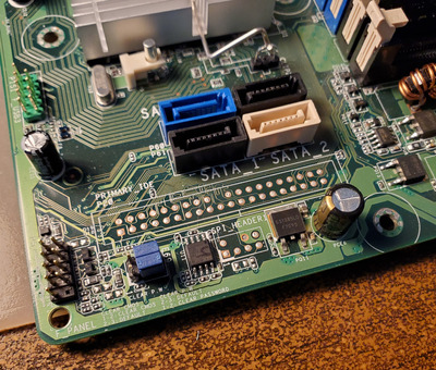

I added a header for the onboard IDE controller, and it worked. However, it's not bootable and is only detected from within Windows. I thought that even if it wasn't bootable, I could still bootstrap it from GRUB4DOS, but both it and FreeDOS fail to detect the drive controller.
I wanted to boot Windows 98 from this IDE controller so that I could enable DMA on an IRA that didn't conflict with other devices. But since it's not bootable, then this project to get Windows 98 running on this system is a failure.
I found some information about the IDE drive controller here:
https://linux-hardware.org/index.php?id=pci:1 … -03ec-1019-2609
Here are some photos of the header attachment process, for your enjoyment.
